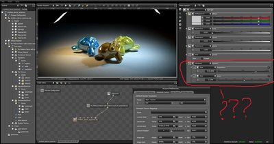

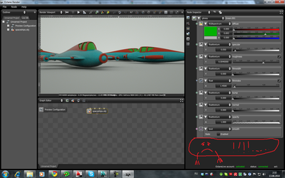

there is no light at the sites, how to turn I do not know
my problem
my problem
Your option
Your option

Elvissuperstar007 wrote:there is no light at the sites, how to turn I do not know
Did you trying changing the material to 'diffuse'?

I think it depends on the type of material used. On diffuse material there is emission and on glossy/ specular- no.

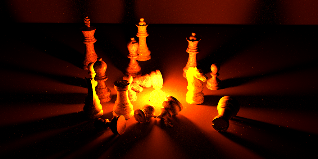

Although I use linux, a version is not available yet. I've done some tests on windows and this is what I found for now.
I must say that I have tested with the 258.96 drivers I had in windows 7.
-As julianb and zay have said, I have noticed a loss of approximately 9.5% speed with this version.
-When I use multi-GPU (GTX260 + gtx470), a strip looks good (less than 1 / 3) and the rest as shown by SamPage. If only use one card works perfectly.
-If I try to save the image using multi-GPU the program closes. With a single gpu works fine.
-I noticed a strange effect when using mesh emitters. From an interior scene without using mesh emitters at 2.8Ms/s, by adding an emitting object, the speed drops to 1Ms/s, then returned the material emmiter to null and the rate remains at 1Ms/s.
Here is a test render.
Cheers

livuxman wrote:I noticed a strange effect when using mesh emitters. From an interior scene without using mesh emitters at 2.8Ms/s, by adding an emitting object, the speed drops to 1Ms/s, then returned the material emmiter to null and the rate remains at 1Ms/s.
Cheers
I can confirm this. It happens to my scenes too if I do that.

livuxman wrote: -I noticed a strange effect when using mesh emitters. From an interior scene without using mesh emitters at 2.8Ms/s, by adding an emitting object, the speed drops to 1Ms/s, then returned the material emmiter to null and the rate remains at 1Ms/s.
Cheers
Same here. Speed drops down and don't go back up when change the material to diffuse or pause/start the render.
