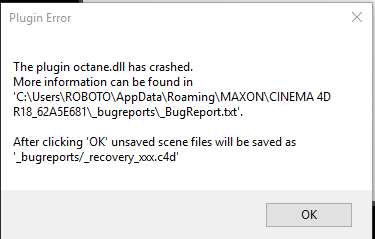

Memory leak/error
Is Octane what crashes, I don't think is because of the textures,.
In the previous version I was using even heavier textures (8k maps for all pieces of the model) and never crashed, it was just the memory problem.
Checked in R16 and R17 as well, same result, it crashes randomly on both LV and PV.
Attached bugreport form cinema and a secreenshot of the message on screen

Interesting! I catched crashes with latest test SDK too. Here is another build with previous SDK(3.04.5). Would be great yo hear some feedback for this! Thanks for you helps!

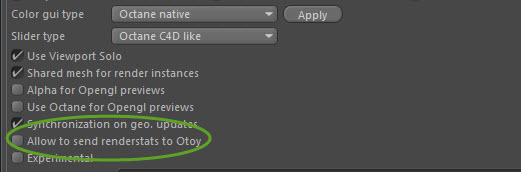

Great to hear!Roboto wrote:I noticed however that in certain instances after closing cinema the memory is not released and cinema 4d remains visible in the task manager of Windows 10, I am not sure if this is a problem of Octane or Cinema4D.
It happens in all 3 versions. It is not too much of hassle as ending the task solves the issue. But may be is worth taking a look?
About other question, i'm aware of that and lookings for reason. Do you have activated "Allow to send renderstats to Otoy"? It may be worth to disable and try again.
