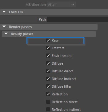

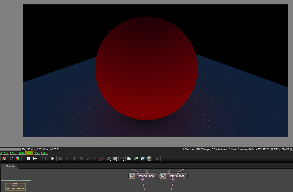

Strange is that I found a problem, trying to test a simple scene, with a simple poly plane with Octane diffuse material, a sphere with octaneGlossyMaterial and a octaneSunSky with Day light env.
On both of diffuse passes, very hight level of noise, even that the beauty looks fine at lower samples, less than 60, for the diffuse pass needs more that 600 to look clean. This was not happened on v2.

I am using 3.04.5 on Maya 2017. Here is the test scene:
https://we.tl/6KsEYqO2xC

ok so I have the same result as you, in Maya2016 and also in Standalone 3.05
but the DiffuseIndirect is different in standalone 2.26.1

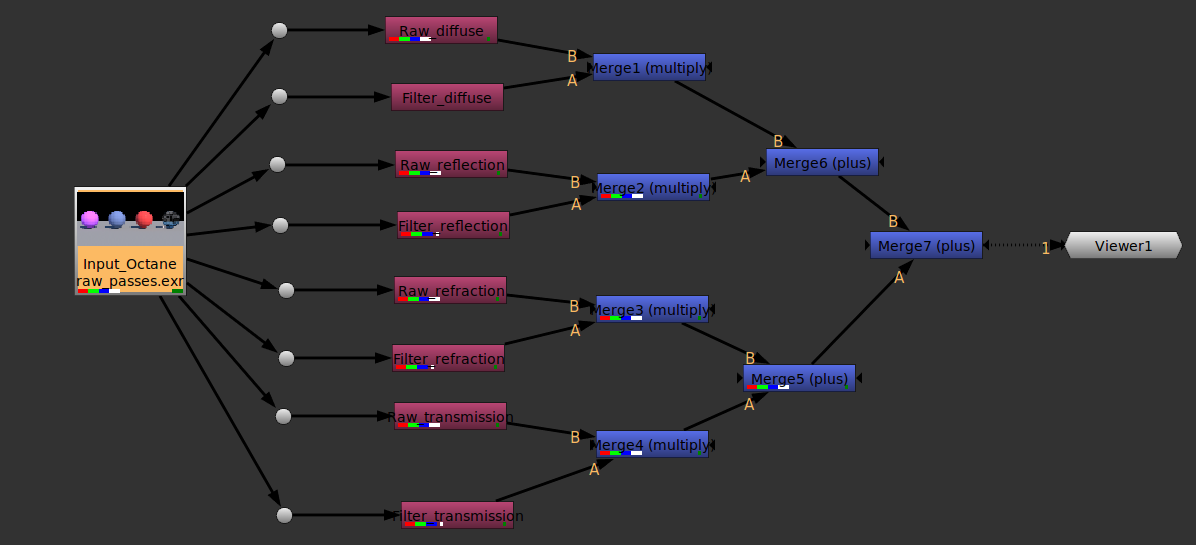

I remember now, this is because in V3 we're supposed to multiply raw passes with filter passes.
So to get the same DiffuseIndirect pass as in V2, you have to multiply the raw DiffuseIndirect with the the Diffusefilter pass.
Or you can just disable the RAW toggle to get directly the same passes as in V2 :D
