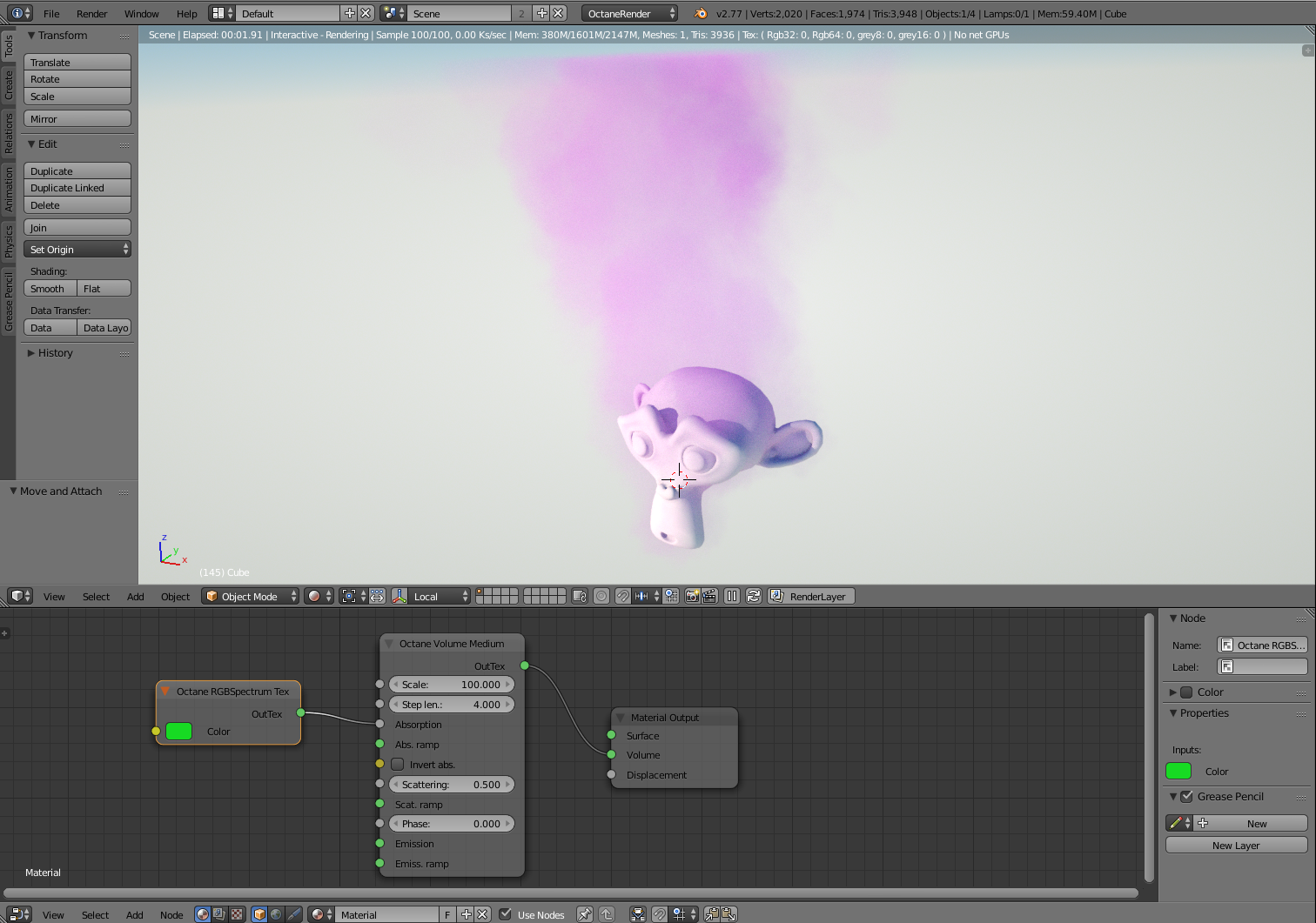

grimm wrote:Thanks, I did try that but the absorption input pin would not accept the RGBSpectrum node's output.
It always worked...
You can either substract color:
or use it directly ("Invert absorption" option):
BTW, will release 10.5 soon today with a fix of your animation problem...

Awesome, thanks Jimstar, I was probably using the wrong node. I will test tonight. :)

Hi Jimstar,
I found the invert check to affect the smoke in a strange way, making it somehow darker. does it also invert the saturation?

With the plugin fixed for animation I created a quick video of the smoke, and changed the color. :)
