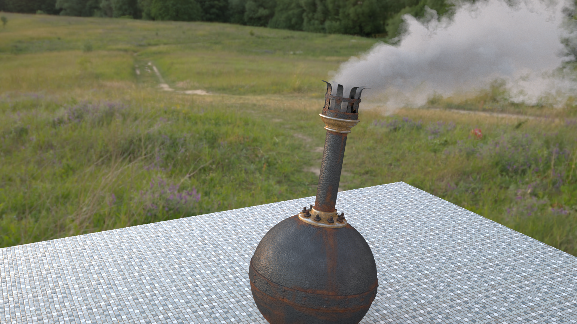

Here is what I have so far, just a quick test with a simple scene.
stats:
scale: 100
step len: 0.5
absorption: 0.3
scattering: 0.3
volume properties from the object data tab:
iso: 1
absorption scale: 500
scatter scale: 500
I should add that I let it render to 500 samp/px.

grimm wrote:Here is what I have so far, just a quick test with a simple scene.
Wow...
pegot
Posts: 954
Joined: Mon Nov 07, 2011 3:44 am
Nice!
