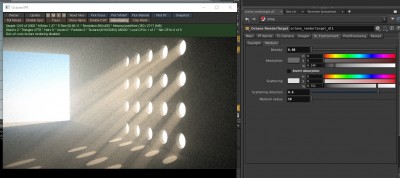

Could the documents please be updated to give a detailed description on the use of the environment medium on how to create atmospheric type rendering.
If there is a resource where this is explained that would suffice, would be grateful for some detailed documentation on the topic.

While updating the plugin docs, you have the description of all the new Octane 3 features in the this thread:
viewtopic.php?f=33&t=51679
Configure the environment medium is fairly easy. Usually the only trick is to be aware about the scene scale to set the medium radios. Anyway I'll build a sample scene to show how it works in Houdini.

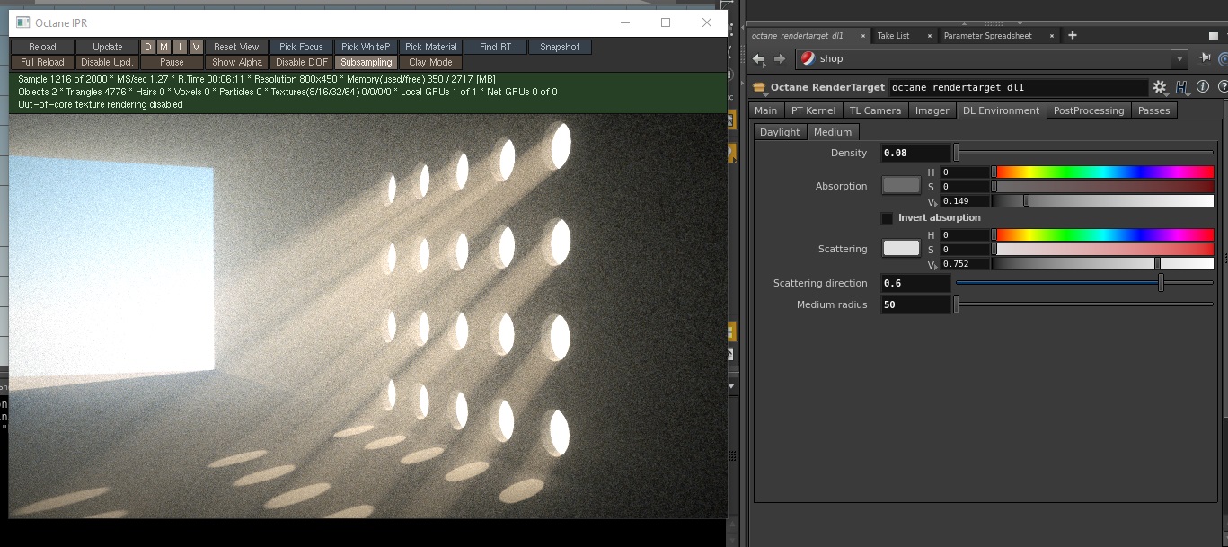

Would very much appreciate an example file for use of the atmospheric medium in Houdini. Where would I be able to find the example? In the docs?
Thanks so much juanjgon,
-T
Attached you have a sample scene using the environment medium. As you can see it is only a matter of play with the medium settings.
Hope this helps,
-Juanjo
