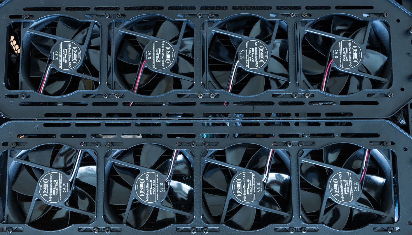

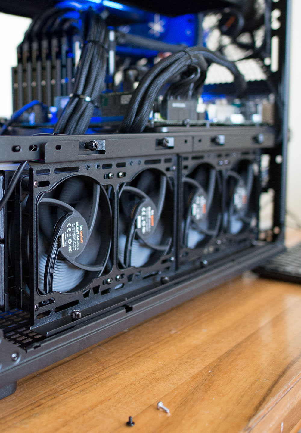

The quietest fan I've ever had is Be Quiet silent wings 3 series - price is crazy but in terms of acoustics nothing is even close. And I am not talking about level of noise itself but its "quality" - I mean how pleasant it is to my ears. EK Vardar 2200RPM (currently on them) have very unpleasant hum at 800-1000RPMs (I'll dump them soon for silent wings 3). But still a great price/value performer is Noiseblocker PL2. Very important is a radiator, its FPI density, over which a fan is mounted. PL2 sounds different on low 8-10 FPI Coolgate than on AC Airplex. My personal choice is to get lower FPI but more of rad surface than high FPI that requires high static pressure fans. And last thing - my recent builds with 7 gpus and 12 cooling unts (3x480 rads) never required more than 1000-1100RPM so PL2 as well as http://www.bequiet.com/en/casefans/722 are fantastic. But if you want to have some extra RPMs http://www.bequiet.com/en/casefans/724 may be handy. PL2 is around 10EUR net, while Be quiet 17EUR net.
