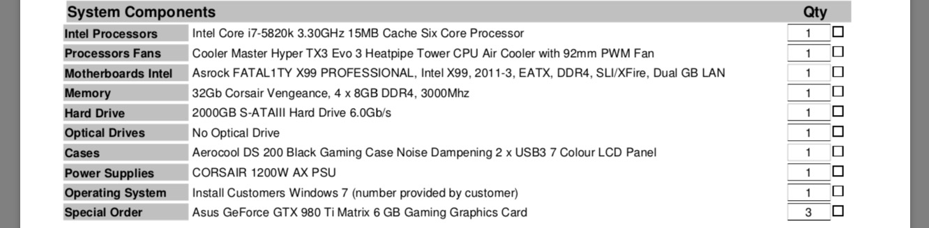

See attached the system they quoted me *note 3 GPUs are quoted because I have a GTX 980ti already as an eGPU.
- Firstly are these decent specs for £2480(roughly $3000)
- Is the 980ti a decent card to multi GPU as my eGPU gets extremely hot. It does have an impressive amount of cuda cores for the cost, but I've noticed octane slows right down when my card gets hot.
- to build on the last comment, is liquid cooling necessary when your rendering an animation if your render times are a few days? The heat of my eGPU is concerning sometimes, but the poor thing is working alone so might be the reason.
- I've told them about Octane and GPU rendering but they are used to building SLI setups so are their any specific instructions I need to give them for the best performance with Octane.
If you have any advice or improvements to this system it would greatly help in building the best system I can within my current budget.

The GPUs will get super hot and start to be very loud and/or throttle, I would advise getting hybrids: http://www.evga.com/Products/Product.as ... P4-1996-KR
Also I don't think that CPU is cost effective at all... most 3D apps only use 1 thead, so the multicore potential of that CPU is not used at all. It's a lot better to get something like a i7 4790K and go 4+ GHz.

Thanks for he reply Phantom!
Ok so I've had a look and it seems these cards are a lot more expensive than the standard GTX 980ti here on the UK. Does the attached fan just provide additional cooling and how are these placed in the case if you have more than one of them?
Would it be beneficial to just start with 2 of these cards and add more later, instead of getting 4 of the ASUS GTX 980ti's?

Mike, first of all, you really, really should build this beast yourself, if at all possible. There are plenty of blokes around here happy to help if you get in a jam.
If you can DIY, you can probably go high-end on everything, with no skimping whatsoever, and possibly end up with some dough left in your pocket at the end...
There are plenty of cases out there that can do four hybrids plus a CLC (closed loop cooler) on CPU too, with room to spare for other fans (intake)... Corsair 900D, a bunch by Fractal Design. Hell, even mine could accommodate five 120mm rads easily and a couple intakes.. I just haven't needed to go to 4 hybrids yet, but am ready when the time comes. My NZXT H630 was like $160 or something...
Hybrids rock. You never need worry about temps. The fans you are asking about are attached to a 120mm radiator (hybrids are liquid cooled, to be clear.. but no worries bro.. it's safe), which heat is expelled from. A 980Ti Hybrid in Octane will likely be around 50° or so under full load. Here in US, one can get a used 980Ti on eBay for around $400 currently.. obviously, you can save quite a bit if we are talking about multiple hybrids. Another thing to keep in mind, right after xmas is a kick-ass time to pick up used GPUs on eBay, Craigslist, etc, when spoiled brats who get Santa to leave the latest/greatest under the tree start to unload them.
