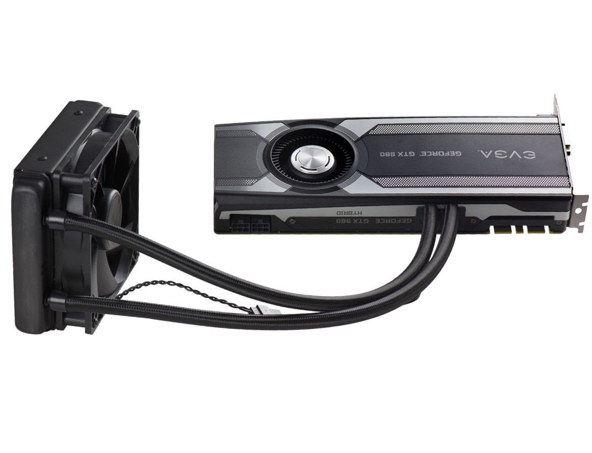

Yes I doubt they will be able to reach the top, wouldn't it just be a case of mounting them where ever they could reach? I know theres proper air flow and technique on placement, but feel like I wouldn't have much choice given the length of the cable.
They should make these things longer with SLI in mind. I feel safe with the 900D being so big, from my observation I shouldn't have too much of a problem with space. I don't quite understand where the screw points are, do the manufacturers build cases and fans at a certain specification? Or do you attach the fans in a certain way.

I was in the same boat as you a few months ago and decided to build a 4x 980ti Hybrid rig. It was the first time I ever built a PC, and was coming from using Macs mostly. It was really easy with the help of some youtube videos, and took me about 8 hours to get up and running.
The Corsair 900D I'm pretty sure is not going to work if you get the hybrid cards. the hoses won't reach the edges of the case... Should be fine for non-hybrid.
The hardest part was finding the right case that could hold 4 hybrids. I ended up getting a Thermaltake x9, which is a cube shaped beast of a case. It's huge, but I was able to fit 3 of the radiator/fans for the GPU + a Corsair 115i Radiator (280mm) on top. And I have one of my GPU radiators on the exhaust on the back of the case.

About damn time someone (with four hybrids) helped this poor bloke Mike out! Thanks bro! I would have thought for sure 900D would cut it, because it seems similar size to my case, but I'm sure you did your homework. Nice catch. Maybe he didn't pull the trigger yet... Mike?

This is great advice man! I'll reconsider the case definitely. I'm really shocked that the 900d isn't adequate, but this case seems better fit for me as it doesn't seem as high, 900d would only just about scrape under having looked at the dimensions.
