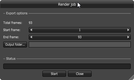

Hi all,
Thanks for everyone who tried the new render job we added to the OctaneRender.
As per request, I'm planning to add the output directory in the render job node itself, but we will still have option to override it from render dialog.
And many requested to add a system to run multiple render job.
Currently we have two options:
- List all render job graphs in the render dialog and allow the user to pick the ones that should be rendered.
Render dialog will be similar to current dialog, but will have list of render job graphs and its frame settings.
- A render job group node
A new render job group dialog will only have start, close buttons, etc. without frame settings
Note: if we need frame settings here, then it will be similar to the first option, with a list of render jobs and its frame settings.
The frame settings in a render job dialog is the total result frames of the render job(not animation frames), this is allowing us to render sub sections or to restart from where we stopped.
And will not make more sense, if it is inside the render job graph itself.
Current render job dialog
Please let me know, What do you prefer or you have any new suggestions?

A render job group node is prefered
Assuming render jobs are going to be queued (it wouldn't make any sens to render jobs in paralelle like render targets inside a render job, as each job is going to have different start and end frame),
We also need a status per job and maybe a cancel button per job.
About the dialog window there shouldn't be any export setting at all here, don't need a start boutton either, just start immediately the render.
If you need more export settings from the user at this point, it means the batch render node is missing something (like for example the output folder).

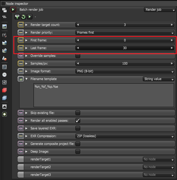

Hi calus,
We do have animation frame settings in the render job node and will add output folder option to the node as well.
Once we complete rendering of multiple render job feature . You can render different render targets with a different animation frame range in a single go/button.
Vijay
Yes this is a frame range override for all render targets in the render job,vijay_thirukonda wrote:We do have animation frame settings in the render job node and will add output folder option to the node as well.
my point is :
because of a design flaw in Octane (missing frame range per render target),
we finally end up with the "multiple render job feature", maybe an over-complicated solution.
A simpler solution might be to fix the design adding frame range attribute to the animation node.
Pascal ANDRE
Also please change the default filename template to something actually usable,
The frame tag %f must always be at the end of the name (before extension), not the pass tag %p,
else the image sequence is not readable by any software
(Yes I know this is the same default template as in the batch render script,
should also be changed there
Pascal ANDRE
would it be possible to do a combination of the two.
in other words, have a render node group which you can connect all, but when the box comes up, it has check boxes like in the other option. this way, you can add to it or subtract as needed at the last second. also having the total frame range isn't a bad idea... when i have render failures it's helpful to be able to start where it failed.
as far as frame range per render target.... just make separate render jobs for different render targets. it's how I'm using it and is working out great. when the master render job node is implemented, then it will be a charm.

calus wrote:Also please change the default filename template to something actually usable,
else the image sequence is not readable by any software![]()
should also be changed there)
we changed the default filename template in release 3.04.3
gah5118 wrote:would it be possible to do a combination of the two.
Thanks for the suggestion. Noted down and will discuss it with the team.
