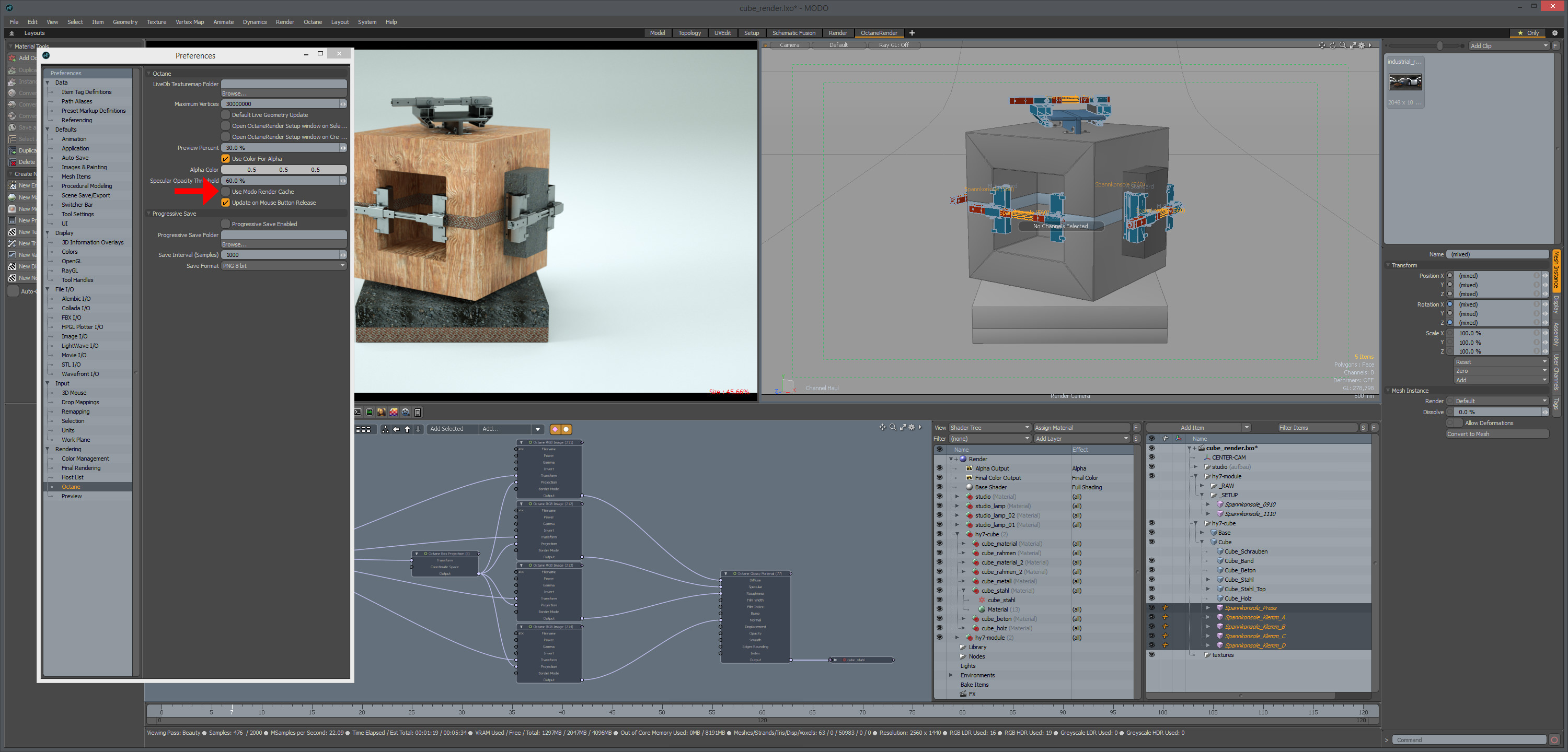

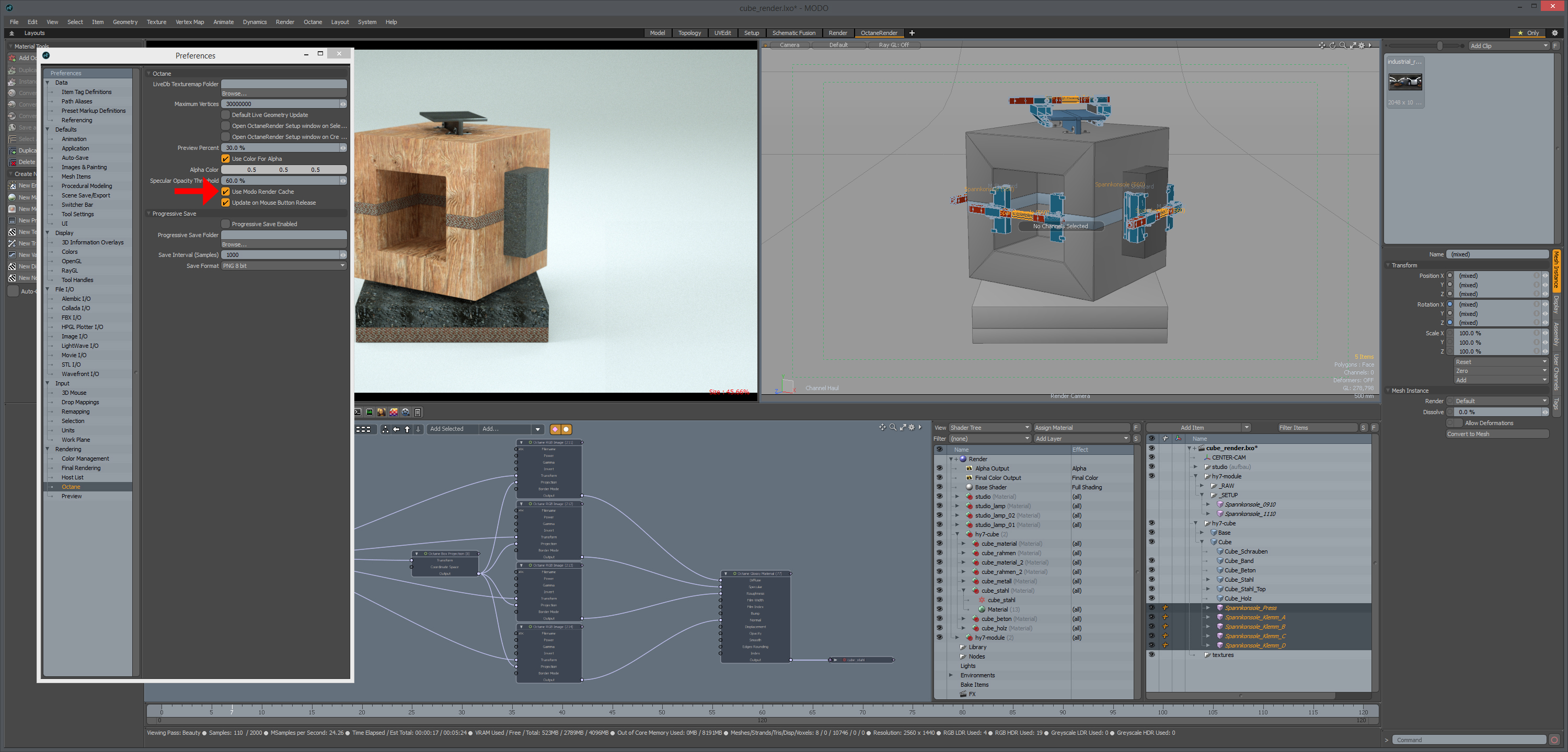

Hello ... stupid question!
If I use in the Preferences --> Octane --> Use Modo Render Cache
Instances will not be rendered, is this normal or is there a workaround other then convert all instances into meshes?
Can you pls re-test this on the next release of the plugin (which I will post a pre-release of in the TEST thread in the next hour - it is version 3.4.3.114).
Paul

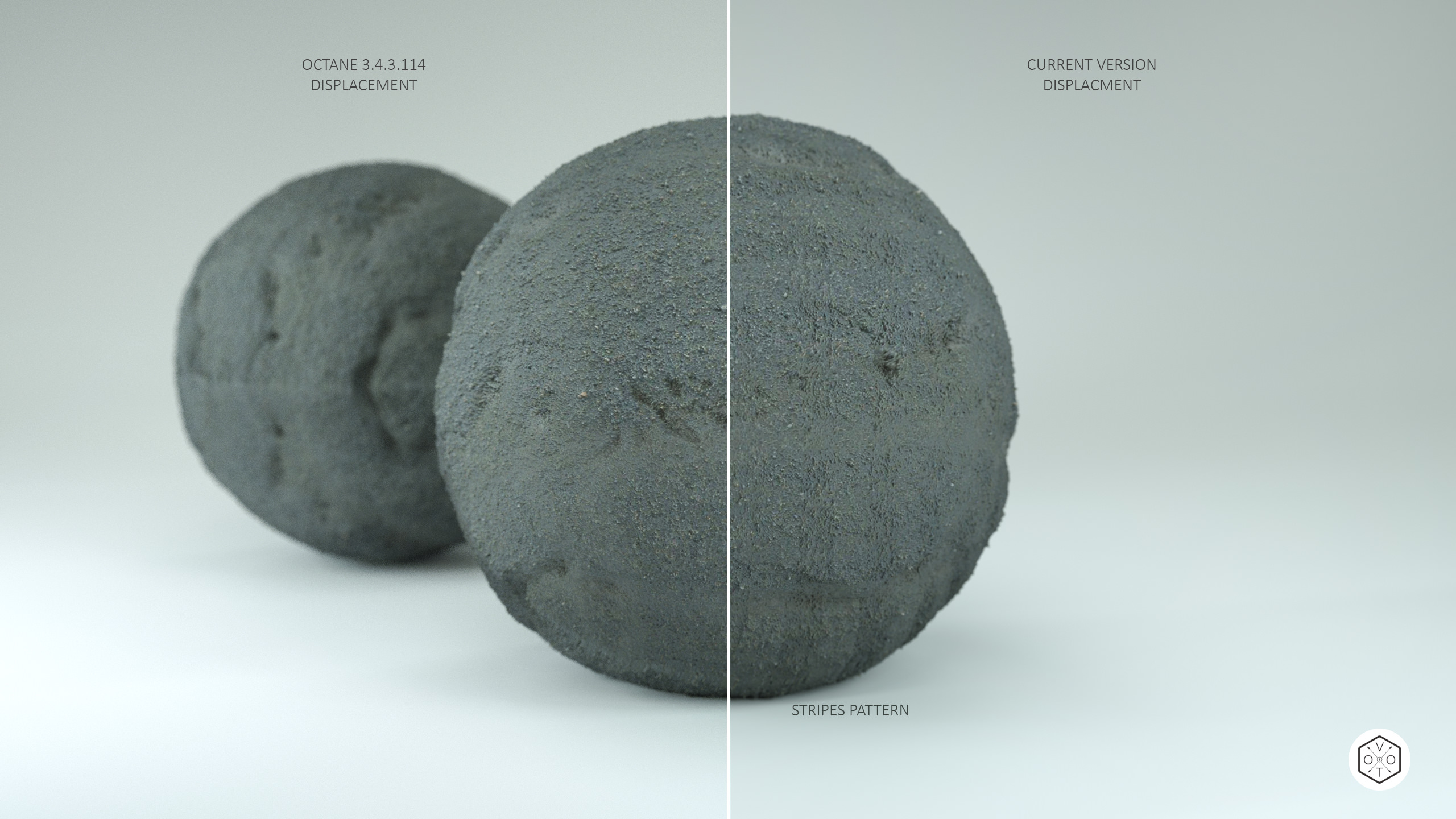

viewtopic.php?f=34&t=54664&p=293413#p293413
The visible pattern from the displacement is gone :) with the new version of the plugin (octane 3.4.3.114).
But the problem with the instance (not been rendered) is still a problem.
The Modo Instance will not been rendered if you use the "Preferences" > "Octane" > "Use Modo Render Cache" :geek:
voto.1979
Windows 8.1 / Octane Standalone Application / GTX Titan Black 6GB + GTX 970 / Intel Core i7-4930K CPU @ 3.40GHZ (6 Core / 12 Threads) / LG 34UC87
