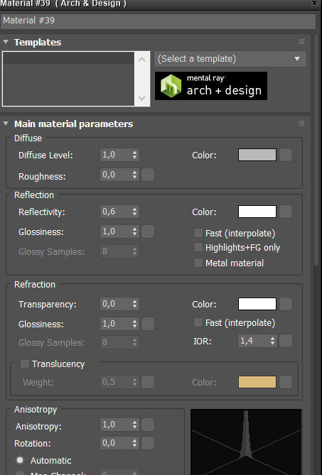

Every new Octane Render for max, at least my material windows shows like these:
As you may see, incomplete. If i change to mental ray, it comes in full width size. Everything is readable.

oh, by the way, Im using max 2017 , with 3840 x 2160 resolution.
showing incomplete material window

Hi rodrigotrovao,
3dsMax 2017 natively supports 4k monitor. The issue you report was previously verified.
It would depend on the new UI 3dsMax and It will be fixed in the next update.
A temporary workaround is to set the screen resolution to 2k.
Regards
