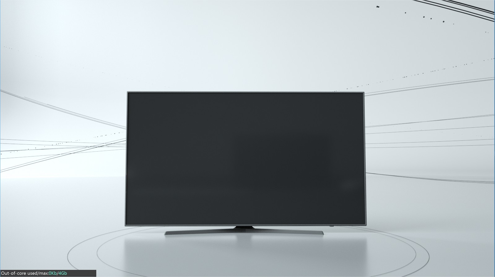

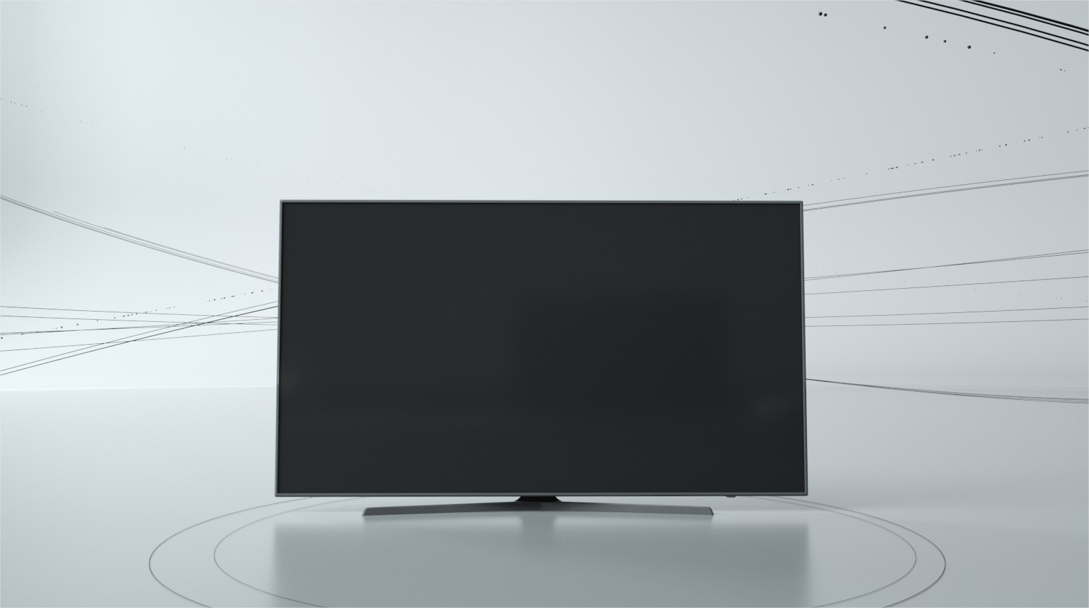

I'm seeing some discrepancies between the last version and this new version. When I load the exact same scene the new version renders it brighter. I'm attaching two images below to show the difference.

sekani20 wrote:Hey,
Only thing is broken is portals on latest version. I hope you don't expect to me estimate what have you used in your scene!! Do you mind to send your scene to let me check?

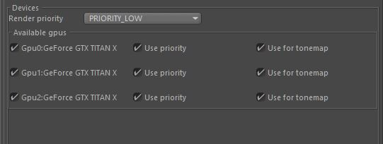

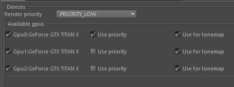

I think in this release the priority settings are messed up, If I choose for all my cards priority low, they go to full speed, If I don't choose anything (no tick) they go to low priority and if I tick they go to full speed no matter what I choose from the tab, (low medium high).
See pics
Can you confirm the same?

sekani20 wrote:Hey,
I found the reason. It's about a change on sdk for empty distribution pins. It had 0.7 default value on floattexture now changed to 1.0. You can add floattexture with 0.7 value as a temporary work-around. I'm waiting next sdk for a fix.
