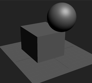

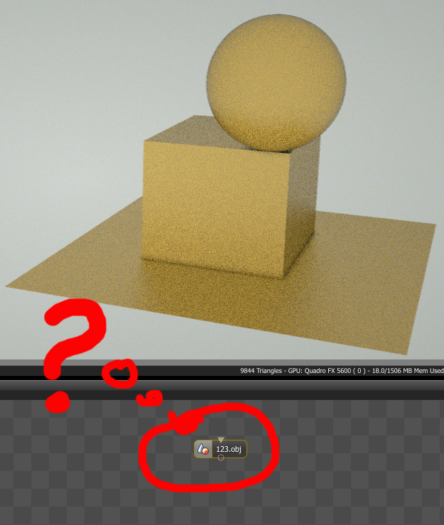

Hello
there are 3 objects in the scene,but octane see's only one. Where is my mistake?Thanks
octane
octane

This is my scene:)
This is my scene:)

at this time, octane supports only one mesh at one time, but this mesh can contain many objects and many materials (that you can assign from max in your case) also you can not move objects in octane, you have to do this in your host app

Does it export an MTL file with material definitions in the same directory as the OBJ file ?
did you assign materials per object in max prior to exporting ?
Radiance
timati
Posts: 12
Joined: Mon Jul 19, 2010 1:19 pm
First question-yes
Second-no
timati
Posts: 12
Cool!!! Thank you so much :oops:
