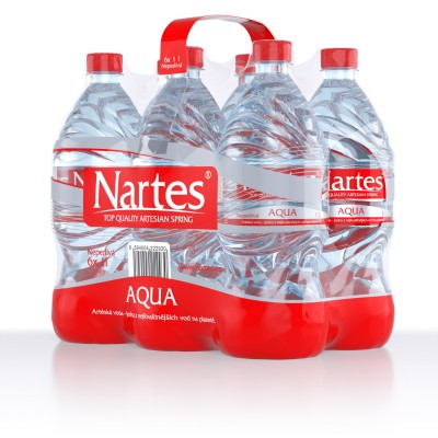

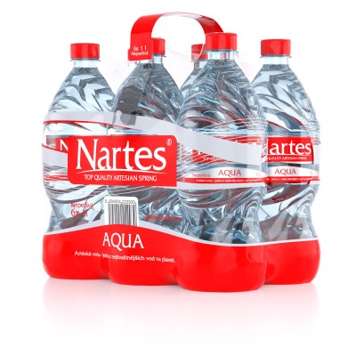

In the Octane 2.25 I was very happy with using the Directlightning kernel / GI_SAMPLE_AMBIENT to render the scenes containing many transparency objects. This setting works very fast providing great results. (img No 1.)
The Pathracing setting is not bad but took much longer time and the transparency isn't so good as with the previous one. (img No1.)
And the point is - after upgrading to V3,03-R1 the SAMPLE_AMBIENT doesn't works with such transparency at all. Why is that or would you know how can I achieve the similar results with some different setting.?
Thanks a lot for advice

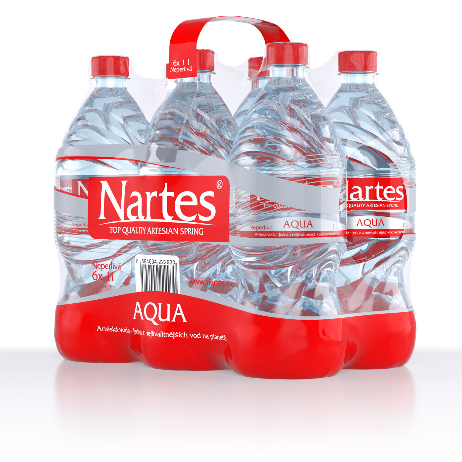

Unfortunatelly it has no effect. See the image.

Hi Nutrend,
please, switch from Sample Ambient to Ambient Occlusion and then reduce at minimum the AO distance value, otherwise the parameter has no effect.
