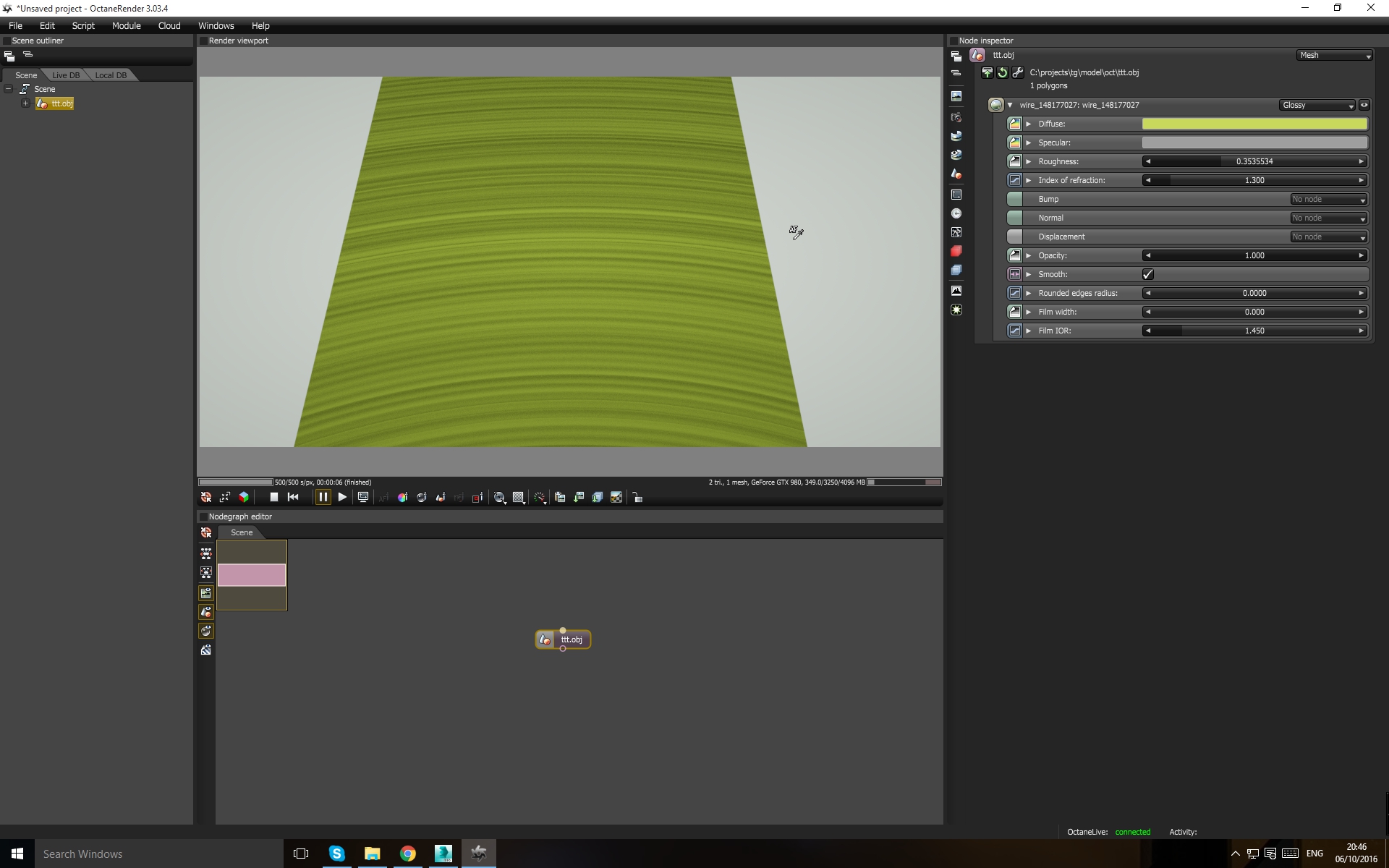

Just can not get rid of this moire ?
I exported it from 3ds max. System unit Meters/ meters and in SA also meters
I thought this problem comes from different unit setup but now I see it isnt
Help please who now the reason !

erges
Posts: 46
Joined: Thu Dec 22, 2011 12:45 pm
HI Tom,
Thanks for your advice. In the exporter scale is always 1.0 , I tried all other switches there....
Yes, Ray epsilonon works when I push this all way up! is it ok if I leave it almost on 1
I get this effect not so often, but now I work on a big scale project (your competition VR project, BTW:) , and get stuck in this f...g moire effect. The scene is very big I've never worked on a such a scale project before (I have a lake 3-4km).
I noticed, when I set scale in Octane in meters and MAX in CM , and when import to Octane I change from M to CM on obj node only, this moire is gone almost, but if I set CM in Octane before import it doesn't work.... Very strange. I tottaly confused, What scale units in Max and Octane I should set to have a right workflow ?

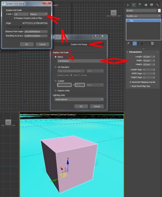

paride4331
Posts: 3862
Hi erge,
Octane uses a metric system.
You should set the correct measurement units in 3ds Max before exporting to standalone.
Incorrect scale unit produces artifacts such as in your screenshot, with emitters, sun and materials.
Units of measurement should be meters, 3dsmax display unit scales counts for nothing.
Regards
