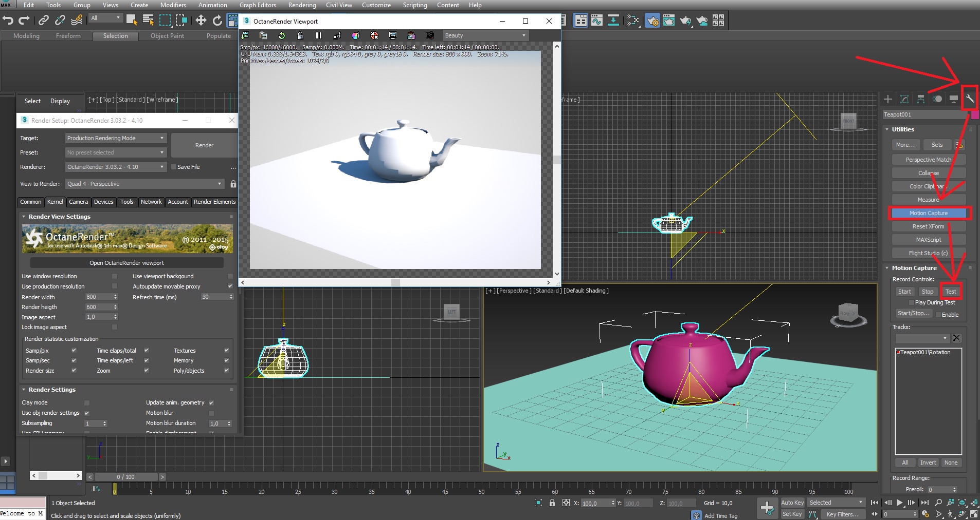

Here is test scene. I configured it to use a mouse as motion capture device, so anybody can test it.
Open Octane viewport then go to utilities (on the left) -> motion capture -> test.
When you move mouse you will see teapot rotating, but octane viewport will not update.
Press escape to stop.
Octane camera doesn't update either.
Strangely, when you press escape Octane viewport updates for 1 or 2 frames.

You are right, its not working during the live Motion Capture Test. It only works when you playback after recording.MoWiz wrote:Here is test scene. I configured it to use a mouse as motion capture device, so anybody can test it.
