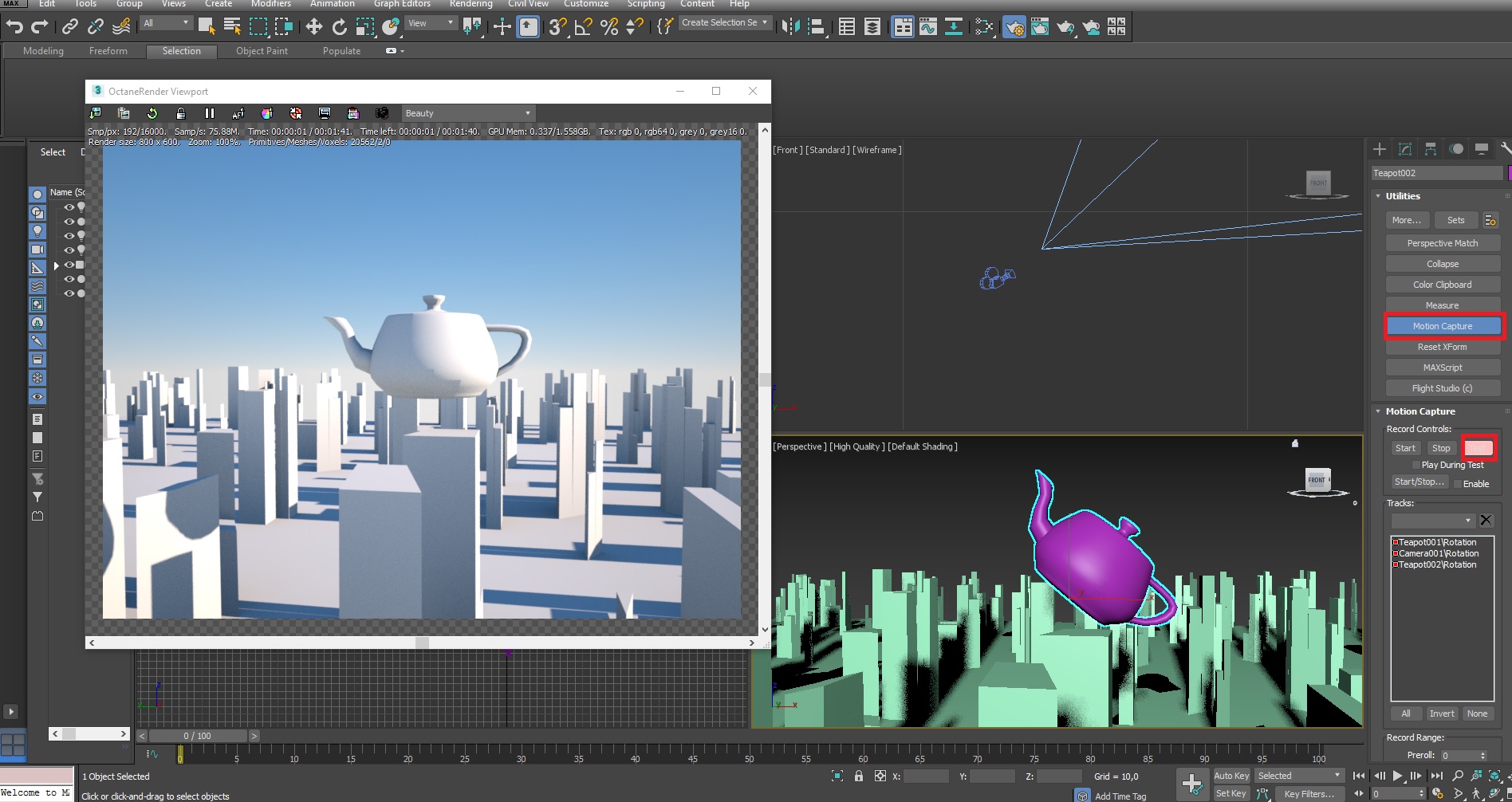

OctaneRender viewport does not update when using Motion Capture from utilities tab.
For example when trying to imitate handheld camera and motion capture OcatanCamera, viewport does not update, there for does not provide any visual feedback.
I have put scene demonstrating the issue in the post down this topic.

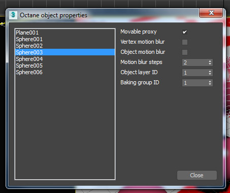

Have you activated the movable proxy to your object?
Regards

I should clarify. I am talking about Motion capture, that is located at utility tab.
First thing I have done is checked a Movable proxy.
Scene is in the next post.

Here is test scene. I configured it to use a mouse as motion capture device, so anybody can test it.
Open Octane viewport then go to utilities (on the left) -> motion capture -> test.
When you move mouse you will see teapot rotating, but octane viewport will not update.
Press escape to stop.
Octane camera doesn't update either.
Strangely, when you press escape Octane viewport updates for 1 or 2 frames.
MoTEST.zip
(101.11 KiB) Downloaded 203 times

You are right, its not working during the live Motion Capture Test. It only works when you playback after recording.
