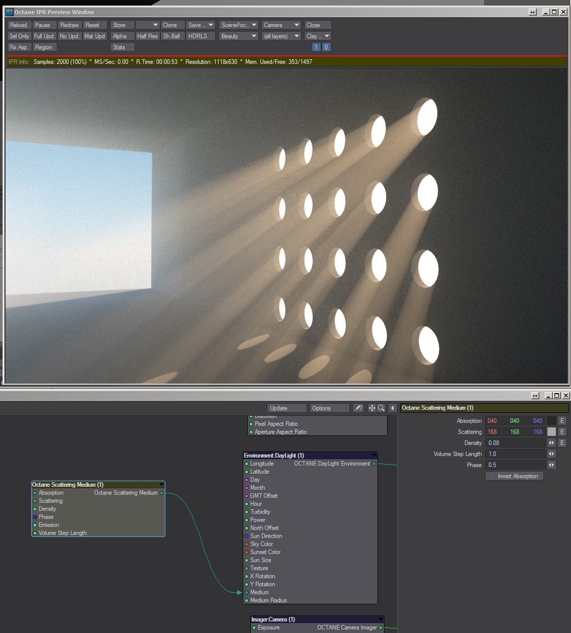

I'm looking at the hazy shafts of light seen in this video on the Otoy resources page.
Is this sort of thing possible?
https://youtu.be/3Pr9f78JwRU
juanjgon
Posts: 8867
Location: Spain
Yes, you need to use a medium node linked to the environment node "Medium" input.
-Juanjo

Thanks Juanjo,
Have you got a quick and dirty example?
juanjgon
Posts: 8867
Location: Spain
Attached you have the scene.
-Juanjo
environment_medium.rar
(21.85 KiB) Downloaded 184 times

Has anyone told you that you are a superstar and a hero ;)
