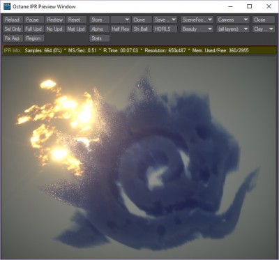

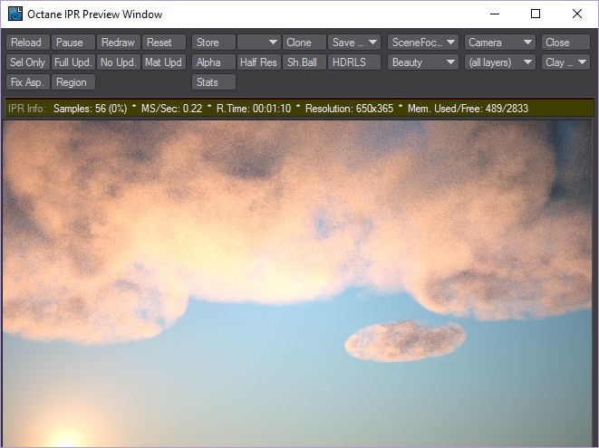

Yes, sorry, a lot of things have changed since this first Octane 3.00 release in the volumetrics system, so some of these demos don't work now. I'll update them (and all the related docs) as soon as possible.
Attached you have the clouds one, that should work fine now with the latest plugin build.
Thanks for your patience,
-Juanjo

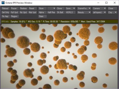

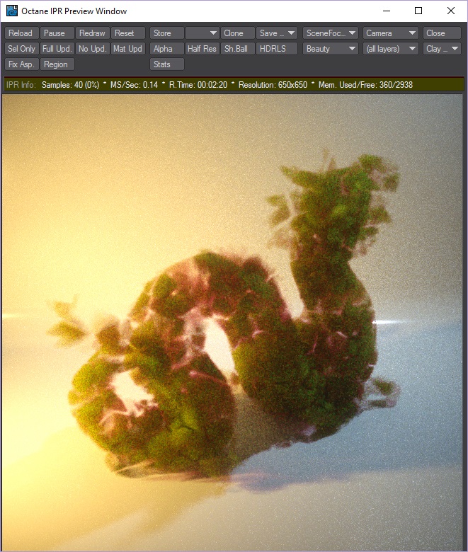

And this is the "Logos" scene.
-Juanjo

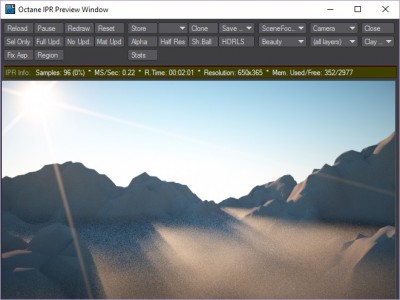

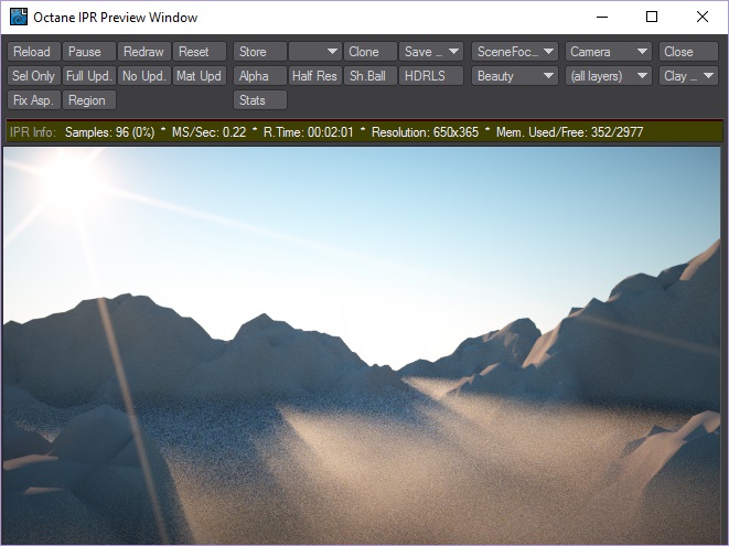

The ground fog scene.
groundFog.rar
(81.52 KiB) Downloaded 226 times

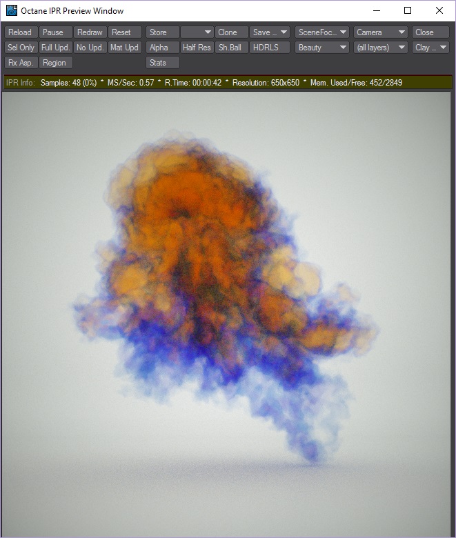

And other set of misc volumetric scenes ...
Hope this helps.
