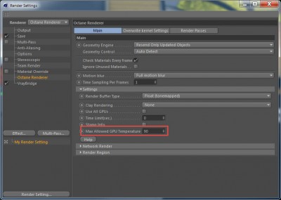

I'm trying to improve a way to control the overheating of GPUs and to disable the related GPU until it get cold. But just works on WINDOWS.
