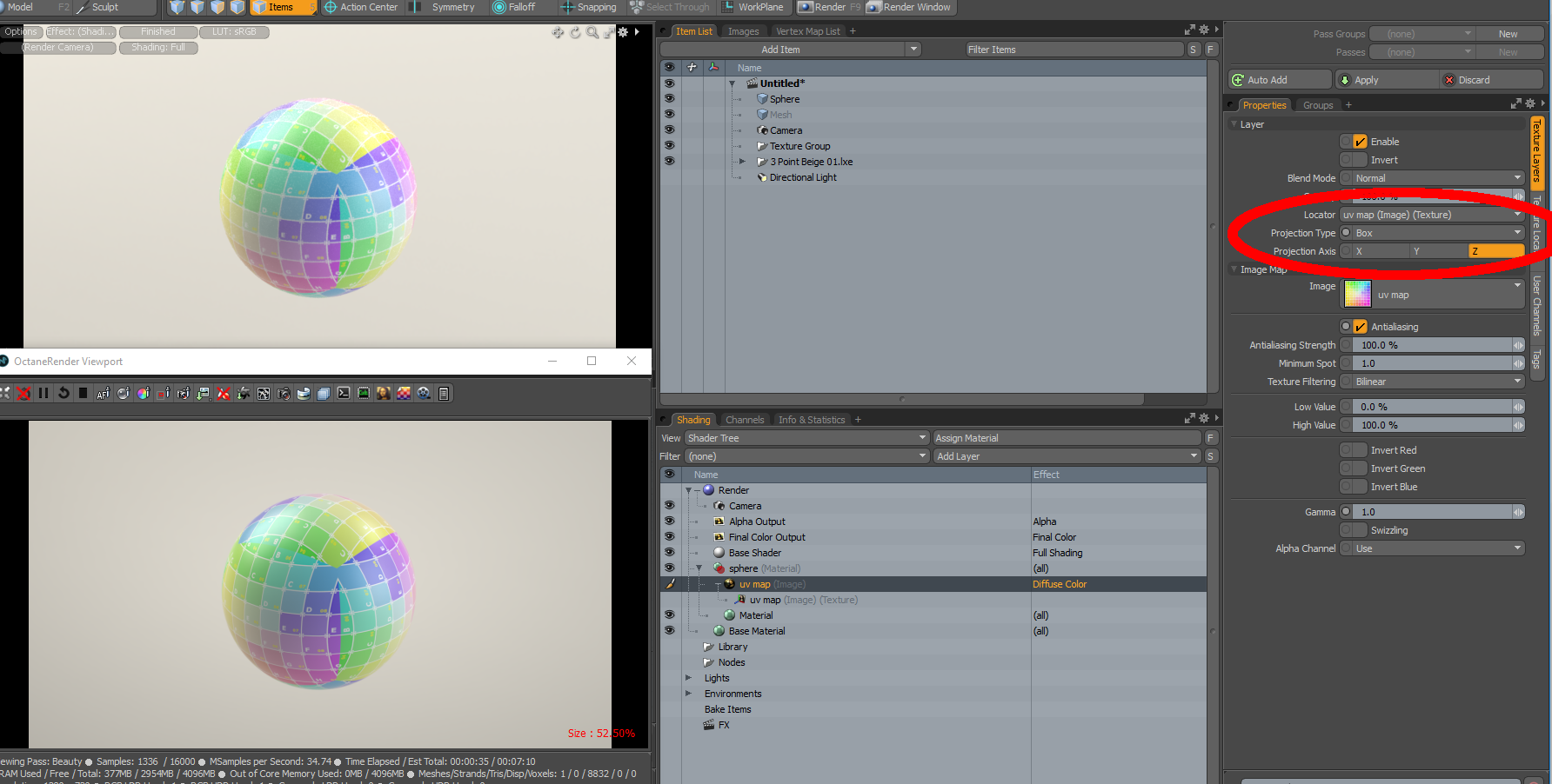

Modo Box Projection mapping translates automatically to Octane Box mapping.

Many thanks but I went with cubic mapping until I have time to have a closer look at this.smicha wrote:I'll try it today later on.MrFurious wrote:I think this is the video you're referring to, It all makes sense I just can't figure out how to apply it in this case

True it does. the issue was that I imported a cad file which for some reason the mapping (cubic and box) did not appear to map correctly in openGL, After unparenting and 'freezing' all items, all was good.face_off wrote:Modo Box Projection mapping translates automatically to Octane Box mapping.
