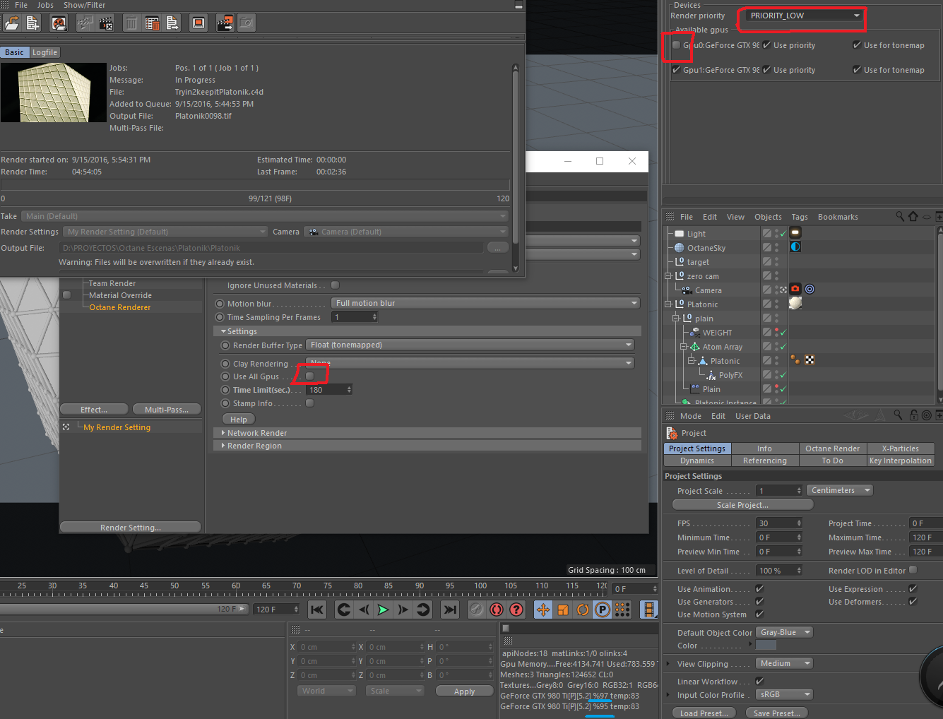

Hi. I´m using the render queue for a big render, but I´d like to keep working while it renders, so I want only one of my two cards (980ti) to be used by octane, but no matter what I input in the settings/devides tab, it´s using both cards at maximum speed and thus the computer is unusable. As you´ll see in my screenshot, bot cards appear with a 95% load. Am I doing something wrong? Thanks

Are you sure to have not ticked the Use all GPUs option in the general Octane Render settings? ciao beppe

Oh, I didn´t know that overwrote the settings on the settings tab. My bad. So, what is the difference between doing it in one place or the other?bepeg4d wrote:Hi rafaelvamp,

Hi rafaelvamp,
In general, you can disable some GPUs while working, but you can also have a particular render setting that always work with all the GPUs, with this option active.

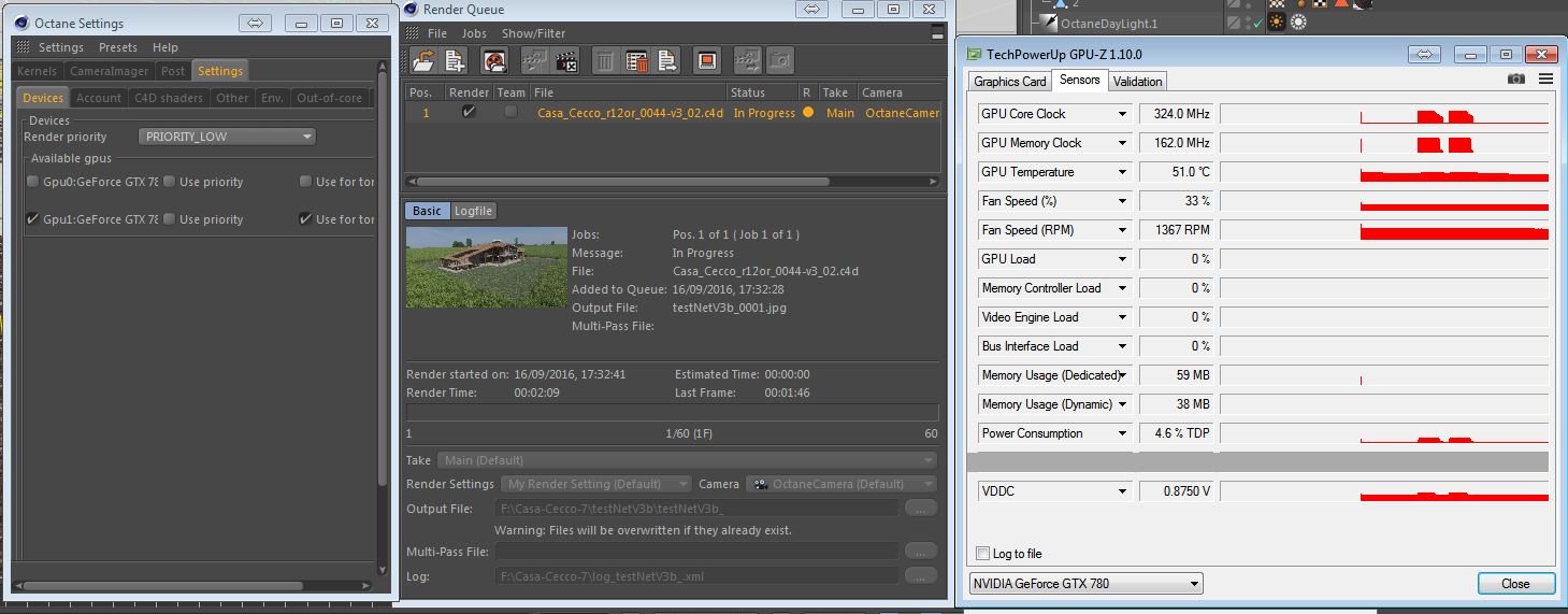

Hi. I´m bumping the topic because I checked with a new scene, where I´m not using the USE ALL GPUS option, and still the priority, and gpu switches have no effect. See the attached screenshot, and you´ll see that even though it´s set to low and one gpu is disabled, both are being used at 100%. ANy ideas?
That's weird
look at this screenshots: here is working as expected
