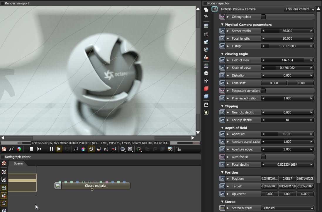

Well if you adjust the parameters you can manually try to get the effect you want using octane lingo
Adjusting the field of view and aperture you could get the results you want I think?
In standalone we have these settings

Thank you again, whersmy!whersmy wrote:Well if you adjust the parameters you can manually try to get the effect you want using octane lingo
I've never used the standalone version, and I simply don't have the time to learn it now (I also don't know if it can't be used for Blender animations?). But that's definitely a lot of features, compared to the Blender plugin. And again, the Field of View parameters are grayed out and I'm not sure they would affect DOF.
Using the plugin, I think it's hard to get something in between the two images you posted; either everything is in focus, or just a tiny sliver like a real-life f/1.2 or something. OK, that's a bit exaggerated, and the renders are certainly beautiful, I would just like to able to do what I can do with my camera.

Thank you womble, yes that looks right. I'll look at my files again, I must have messed up something.womble wrote:these are my settings and everything seems ok...
