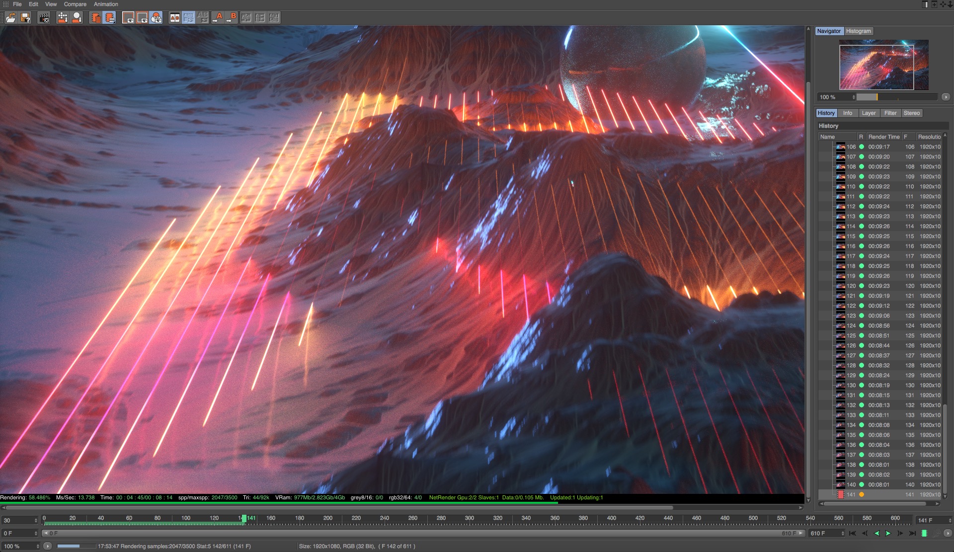

Posts: 10514
Hi hellomono,
I can confirm what abstrax said, I have rendered more than 140 frames during night without any issue on my system with 2x780 + 970:
It must to be said that the scene could be optimized, especially for objects with displacement, because now everything is movable :roll:
One question, have you ever installed the standalone at least one time?
During installation, it changes a registry in Windows that helps when working with displacement.
ciao beppe
