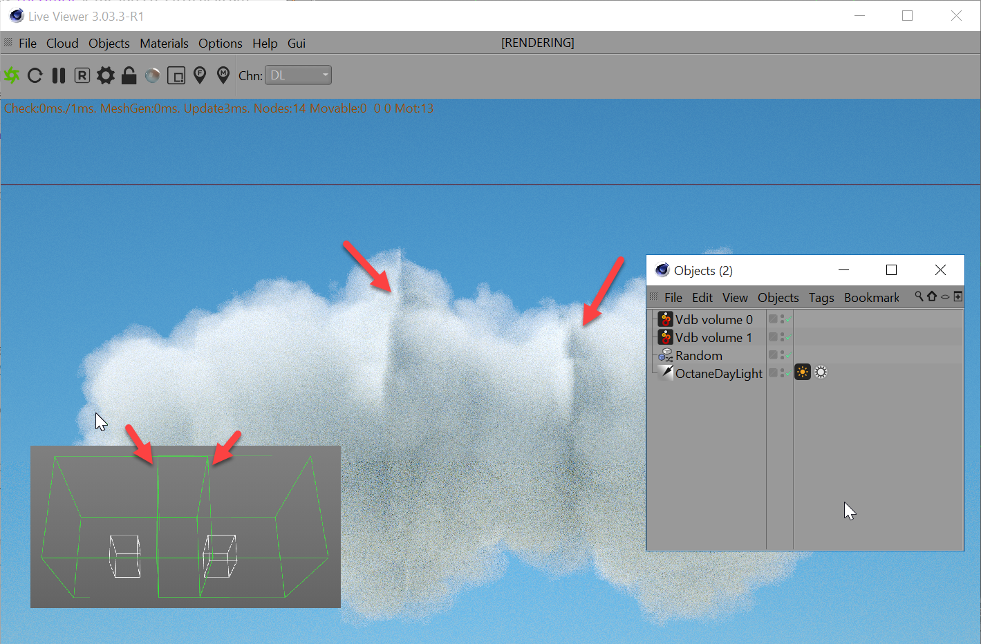

There is a problem where overlapping VDB. Shadow problem.

Having exactly the same problem as you @ eyeonestudio!
My workaround was to set the volume step length from 4 to 2 or better to 1,5.
But i am sure, that it should work without that adjustments... would like to get some more infos too.

Hi guys,
it should work if the volume step length is the same for both the volumes.

Hello,
are there any hints how to get rid of these shadows with intersecting VDBs as mentioned by eyeonestudio? I am having several clouds too, and the more i understand how to tweak their look the way i would like them to look the more i run into this shadowproblem. I have searched for an answer, but i can´t find any solution. Please answer to my and eyeonestudios question. Make invisible for shadows does not work too...

Hi Chriz and eyeonestudio,
I have revisited my test scene and I can confirm that there is an issue with overlapping volumes, in theory this is allowed with a maximum of four volumes, but some artifacts are visible even with two
Anyway, this is not a plugin related issue, but comes from SDK.
I'm going to prepare an orbx that shows the issue and share it with haze, I'll keep you informed.
