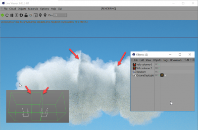

There is a problem where overlapping VDB. Shadow problem.

Having exactly the same problem as you @ eyeonestudio!
My workaround was to set the volume step length from 4 to 2 or better to 1,5.
But i am sure, that it should work without that adjustments... would like to get some more infos too.
Have a nice day, Chriz
http://www.C9W.de - Win10 - Dual E5 2620v3 - Display 1 GTX 1080 / Render 1 3090 RTX - 96 RAM - C4D MSA - C4D Plugin version: current - Standalone: current

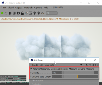

Hi guys,
it should work if the volume step length is the same for both the volumes.
ciao beppe
ciao beppe

Not Working Here....bepeg4d wrote:Hi guys,
ciao beppe
Path Tracing Kernel
Same Density, Same Volume Step Length
CINEMA 4D R2025
Win11 / AMD 7995WX, 3995WX, 3990X, Intel 10980XE / 256Gb RAM / RTX4090, RTX3090 / 100GbE, 40GbE, 10GbE

Hello,
are there any hints how to get rid of these shadows with intersecting VDBs as mentioned by eyeonestudio? I am having several clouds too, and the more i understand how to tweak their look the way i would like them to look the more i run into this shadowproblem. I have searched for an answer, but i can´t find any solution. Please answer to my and eyeonestudios question. Make invisible for shadows does not work too...
Is this an actual limitation or where is the magic "make clouds pretty" button?
Thanks a lot!
Chriz

Hi Chriz and eyeonestudio,
I have revisited my test scene and I can confirm that there is an issue with overlapping volumes, in theory this is allowed with a maximum of four volumes, but some artifacts are visible even with two
Anyway, this is not a plugin related issue, but comes from SDK.
I'm going to prepare an orbx that shows the issue and share it with haze, I'll keep you informed.
ciao beppe
ciao beppe
