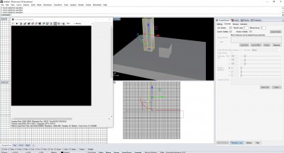

Hi Paul,
I'm trying to bake a very simple scene with multiple objects - each is to have their own baking group and texture.
The first group/object bakes correctly - with baking group 1.
However the other objects appear black when attempting to render out their baking groups.
Likely I am just inexperienced and have missed something - have you any ideas?

Have you select Baking Group 2 in the Baking Camera?I'm trying to bake a very simple scene with multiple objects - each is to have their own baking group and texture.

Yes - baking group 2 was selected both in the rendertarget (Baking Camera) and the object (live update and baking group). The same applies for baking group 3.face_off wrote:Have you select Baking Group 2 in the Baking Camera?
I've attached the Rhino file if it's of any use. Perhaps it's something specific to my setup (I also get an error, 'failed to save scene', however it doesn't crash, I just have to click OK. This is unrelated to the baking issues and occurs on most renderings)

All objects in the scene are assigned to baking group 3, and when I select baking group 3 in the camera, they render correctly.Yes - baking group 2 was selected both in the rendertarget (Baking Camera) and the object (live update and baking group). The same applies for baking group 3.
Do you have write-access to the folder you are saving to? Try running Rhino as Administrator to test.(I also get an error, 'failed to save scene', however it doesn't crash, I just have to click OK. This is unrelated to the baking issues and occurs on most renderings

Ah.. I found the solution. Whilst I had changed them to be individual baking groups, I had 'No Meshes Live' selected in the options....face_off wrote:All objects in the scene are assigned to baking group 3, and when I select baking group 3 in the camera, they render correctly.

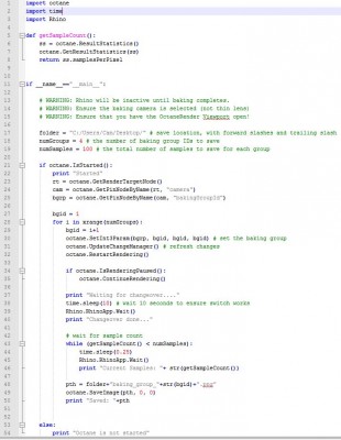

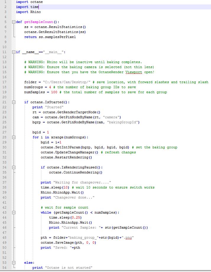

Here's a quick script using the python API to automate the baking groups... (The forum won't let me post any python script...)
It works well, but any tips regarding API usage would be welcome. The main thing was that it needs a wait time to ensure that the scene is properly updated and the sample count is properly reset, otherwise it double-saves each image before reloading (and hence skips every second one) - line 37.

Looks great!
You can paste code using the 'Code' button when typing your message.
Your code looks fine. You may not need the RestartRendering (since the UpdateChangeManager will do that). And do you need the 10 sec sleep?

Some sleep is necessary - the 10 sec is overkill just to be safe. Probably one or two seconds is fine, but when leaving something overnight to render I'd rather be safe!face_off wrote:And do you need the 10 sec sleep?
That wait is there to ensure that it doesn't check the sample count before Octane has actually loaded (rendered and update the first sample) of the next bake. If it's not long enough (and the load time is slow for a complex scene and 4K texture) then it will occasionally save the same frame twice (checks sample count, sample count hasnt updated, so it reads that it's completed the sample amount and saves twice, essentially skipping a render).
