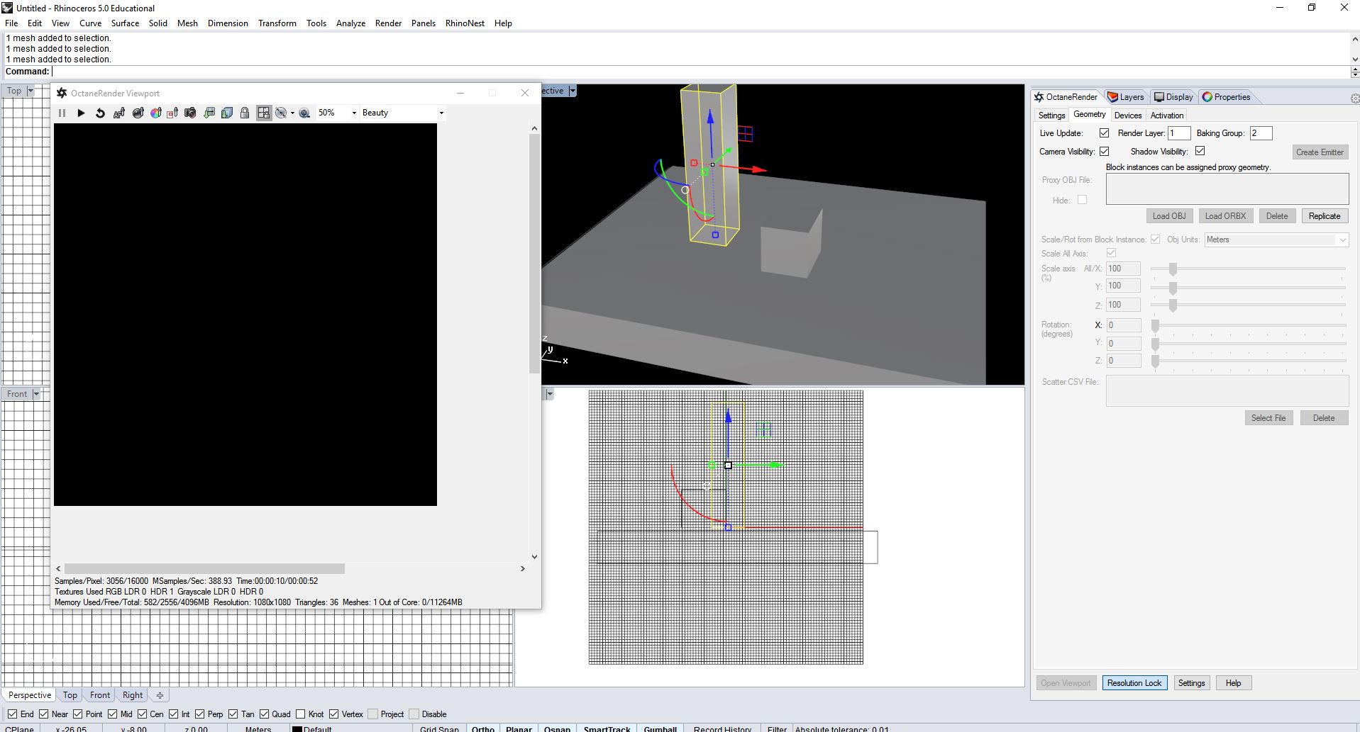

I'm trying to bake a very simple scene with multiple objects - each is to have their own baking group and texture.
The first group/object bakes correctly - with baking group 1.
However the other objects appear black when attempting to render out their baking groups.
Likely I am just inexperienced and have missed something - have you any ideas?
Have you select Baking Group 2 in the Baking Camera?

face_off wrote:Have you select Baking Group 2 in the Baking Camera?
Yes - baking group 2 was selected both in the rendertarget (Baking Camera) and the object (live update and baking group). The same applies for baking group 3.
I've attached the Rhino file if it's of any use. Perhaps it's something specific to my setup (I also get an error, 'failed to save scene', however it doesn't crash, I just have to click OK. This is unrelated to the baking issues and occurs on most renderings)
All objects in the scene are assigned to baking group 3, and when I select baking group 3 in the camera, they render correctly.

face_off wrote:All objects in the scene are assigned to baking group 3, and when I select baking group 3 in the camera, they render correctly.
Ah.. I found the solution. Whilst I had changed them to be individual baking groups, I had 'No Meshes Live' selected in the options....
