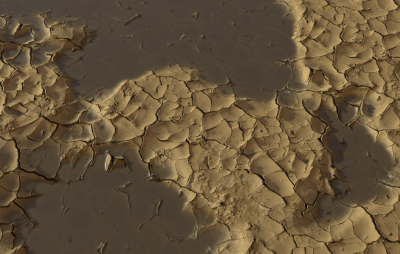

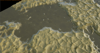

using the displacer gives a much better result than using the map in the displacement channel of the material
Even if you use the classic workflow "MBB_QUIXEL_PBR_ and saving into the Local DB (which BTW, there is no way to save a material preview anymore as a thumbnail?)
the material does not look quite the same.
Someone correct me if I am wrong.
In Megascans studio, the material has plugged the AO and CAvity, which gives really nice depth.
What would be the workflow to get the exact result displayed in MS studio?
first is MS studio
second Image is in octane with the displacer
first is MS studio

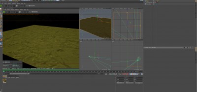

I know this is an old thread but i just caught wind of Megascans and have bought one of their packs. For one, i didn't receive a download link for any materials apart from Bridge and Studio.
Not sure if i'm missing something?
I've tried some of the free materials on a flat plane along with a model i had with not so great results, actually their really bad. I've attached a photo so you can see what i mean.
Keep in mind that i'm new to both C4D and Octane.
