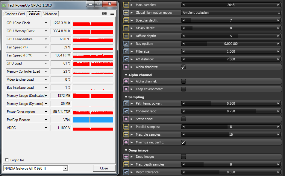

This is what happen when I try to render with C4d plug or with the bench.

Are you measuring the gpu load on the same scene?

I checked with Otoy - and in order to get 100%, you need a complex scene, since with a simple scene everything is running too quickly to max out the GPU. See "overhaul of the integration kernels" in viewtopic.php?f=24&t=51679.
I tested with a simple and complex scene, and the Modo plugin and Octane Standalone produced the same GPU loads with GPU-Z.

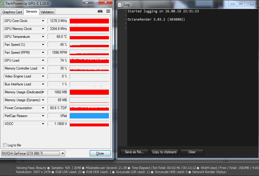

Hello guys,
I tested Modo (always the version 10) with the 2 different octane plug-in.
I post the screens here:
Modo 10 Octane 2
Modo 10 Octane 3
As you can see the GPU Load Value change. The scene is always the same, it's an interior (so quite heavy).
Any suggestion?
Thank you all!

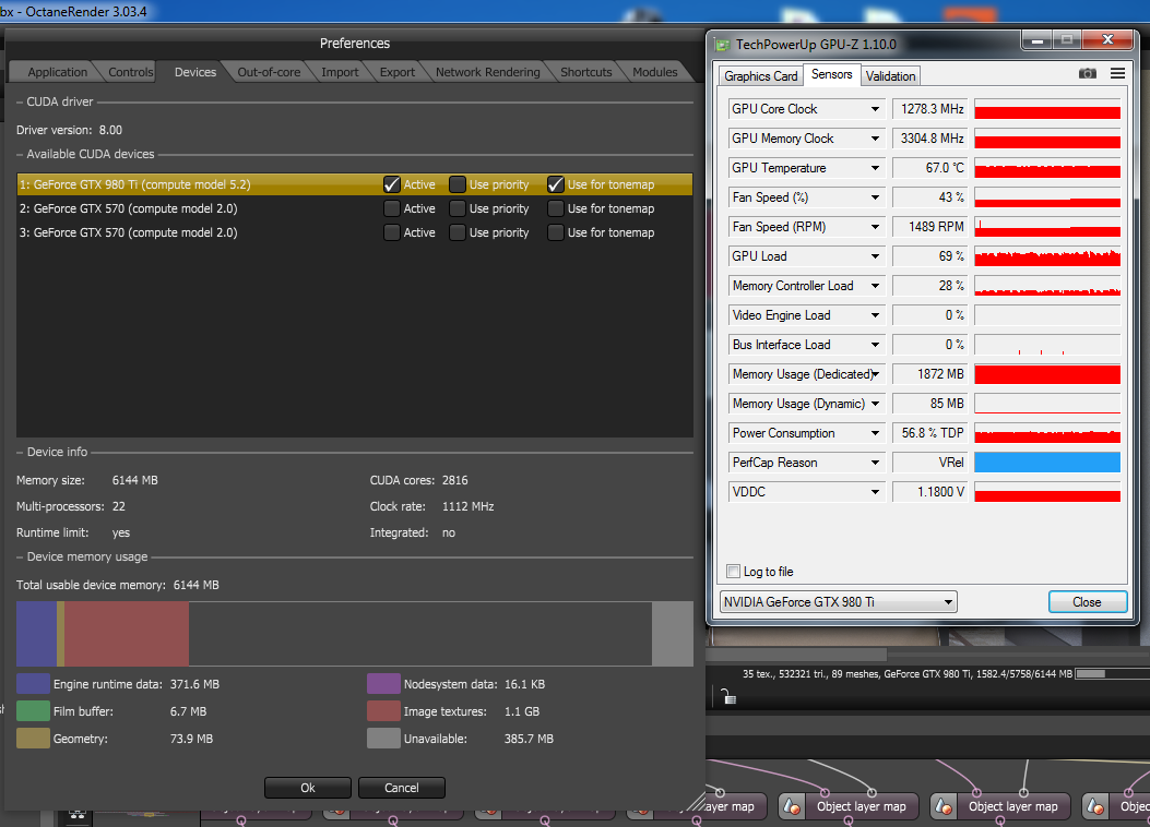

What are your Cuda Device settings set to pls?
If you export the scene to ORBX and render in Octane Standalone 3.04, what GPU utilization do you get?

There we are.
I exported the scene in Orbex, just lunched in Stand Alone and this is the results.
If you need of more piece of information let me know.
Thank you!

oguzbir
Posts: 715
Joined: Fri Jun 25, 2010 12:30 am
Please check kernel settings
Lower the Parallel samples 1
MAx tile samples 1
When I do this max usage is fluctuating around 65-75
If I set paralel samples to 16 and max tile samples to 32 I get gpu usage fluctuating around 95- 85
this is in standalone and same goes for 3Dsmax plugin
It has to be something about this matter.

actually this is the Kernel.
It-s running in DL
