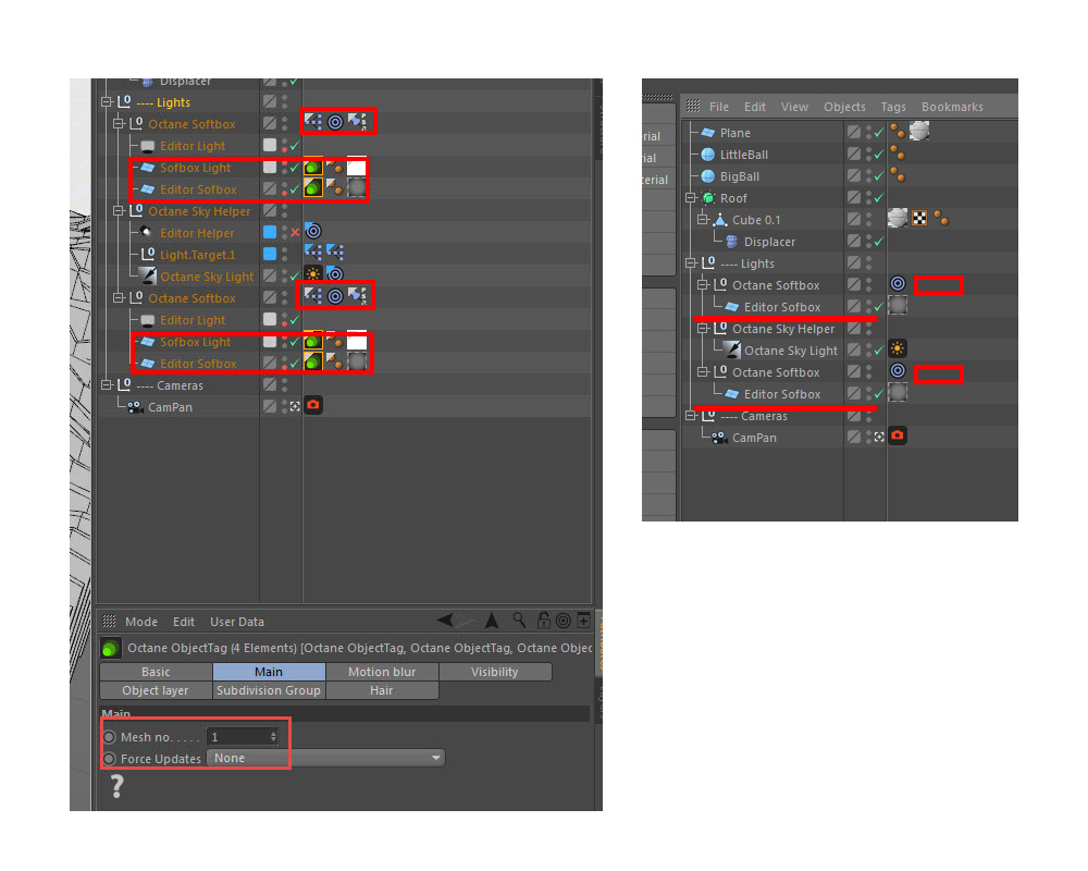

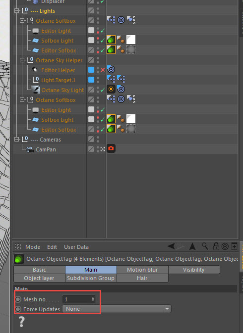

I'm not sure about exact reason. Maybe a bug in plugin with meshno=3 and these objects. It's a long topic.
Use layer manager to make visible all objects in object manager. then select tags and change values to 1-2.

True, seems a bit above what I need to know. Thank you for the tip with the layer manager.

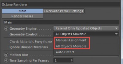

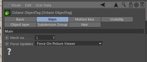

Ok i see. When some meshes are not updating try this option. I'm gonna check this issue after come back from a vacation.
Or this options
