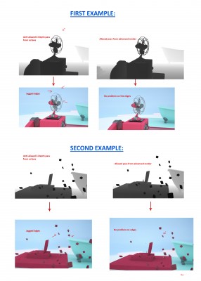

Hello,
I've seen a similar post with no answer, so I wanted to create a new, more detailed post.
I have a problem with the z-depth pass exported (32bit .EXR) from octane.
With Frishluft (or an other plugin), the edges are jagged.
Because this pass seems to be anti-aliased, and to use it in after effects, it should be aliased.
So, what I do know is export my z-depth pass with Advanced render, and I get a better result.
Here are a screenshot to compare the compositing in after effects:
Watch it at 100% résolution

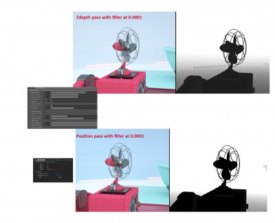

Thanks Terry,
I've just made the test, and it's the same, as you can see in this picture.
I thought that it Will work. :(
