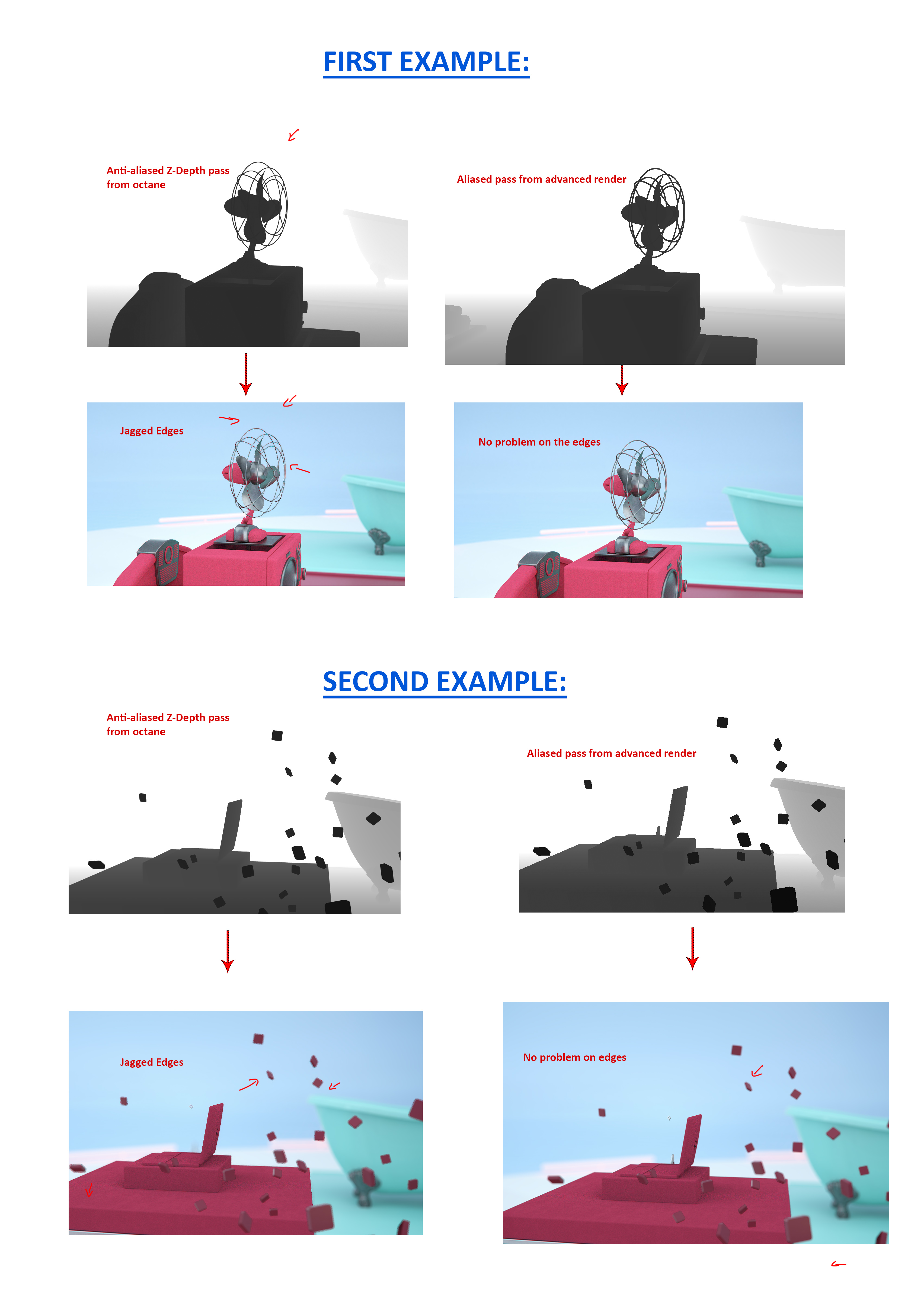

Hello,
I've seen a similar post with no answer, so I wanted to create a new, more detailed post.

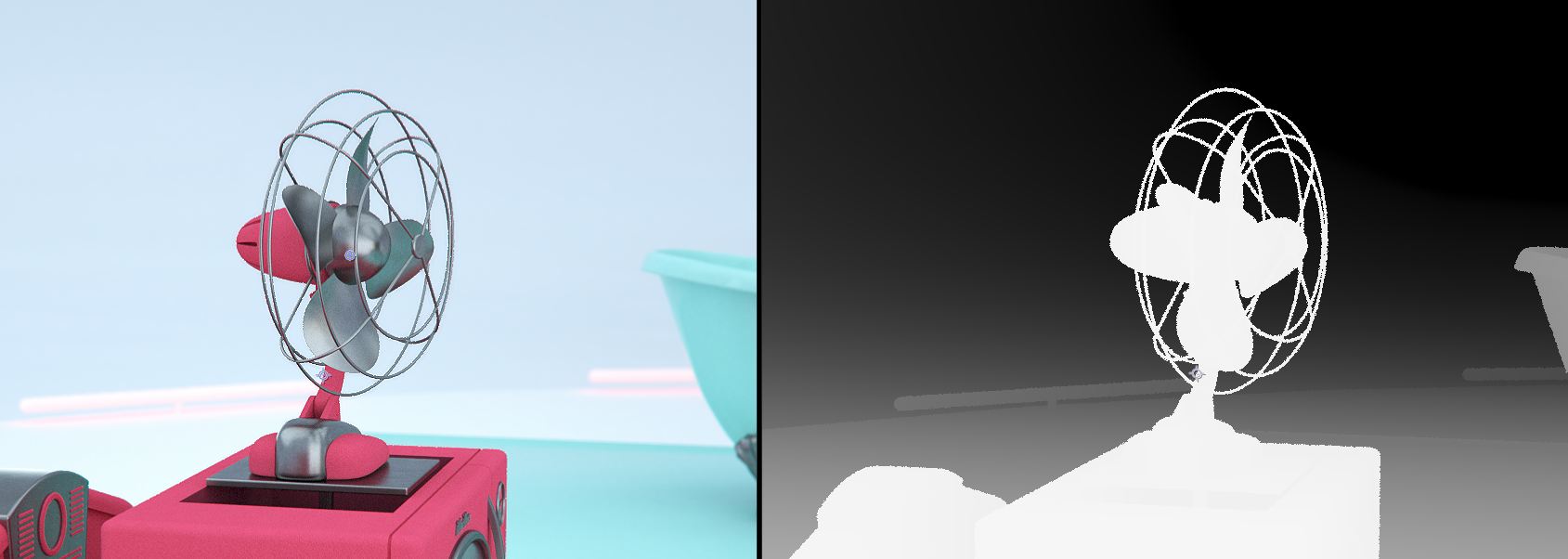

I have a problem with the z-depth pass exported (32bit .EXR) from octane.
With Frishluft (or an other plugin), the edges are jagged.
Because this pass seems to be anti-aliased, and to use it in after effects, it should be aliased.
So, what I do know is export my z-depth pass with Advanced render, and I get a better result.
Here are a screenshot to compare the compositing in after effects:
Watch it at 100% résolution
So, Is that an octane core problem, or it can be solved by the fabulous Aoktar ?
Thank you

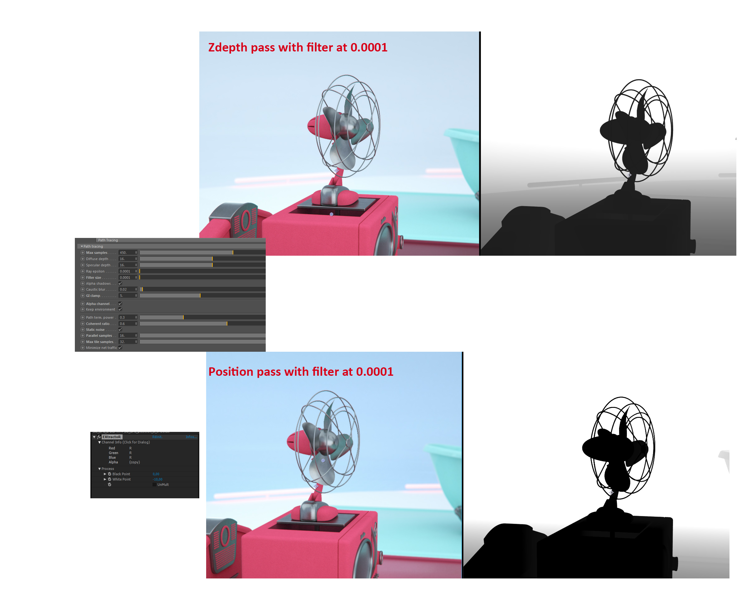

Postby FxDesign » Thu Aug 11, 2016 3:55 pm
FxDesign Thu Aug 11, 2016 3:55 pm
Thanks Terry,
I've just made the test, and it's the same, as you can see in this picture.
I thought that it Will work. :(

If you use only 1 sample for info pass and filtering to 1, your info passes are aliased.

Postby FxDesign » Thu Aug 11, 2016 8:15 pm
FxDesign Thu Aug 11, 2016 8:15 pm
Good Idea Calus,
So I've tried with one sample and the issue is worn edges now.
It's better, but it doesn't really work
I've tried with 4 - 8 -10 -15 sample and the result isn't better.
FxDesign
Posts: 80
Joined: Wed Apr 24, 2013 10:47 am
Re: Z-Depth pass problem (Anti-Aliasing/jagged edges)
Postby calus » Thu Aug 11, 2016 8:32 pm
calus Thu Aug 11, 2016 8:32 pm
right , not really usable :D
but as far as I know 1 sample is the only way to have aliased passes with octane. :(
