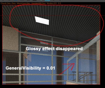

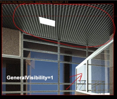

When I set GeneralVisibility paremeter closer to 0, highlights on glossy materials disappears and lighting becomes uniform.
Maybe I'm doing something wrong. Explain, please
GeneralVisibility = 1
GeneralVisibility = 0.01
Win7, i7 950, 12Gb RAM, GTX580
Posts: 10468
Hi R_Flash,
nothing wrong from you, but this is expected if you cheat by hiding the visibility of the emission. As you can see, the general luminosity is not changed, but the image is completely different because glossy and specular materials have nothing to reflect or refract.
Have you already tried to reduce the reflectivity of the window's glass instead?
ciao beppe
