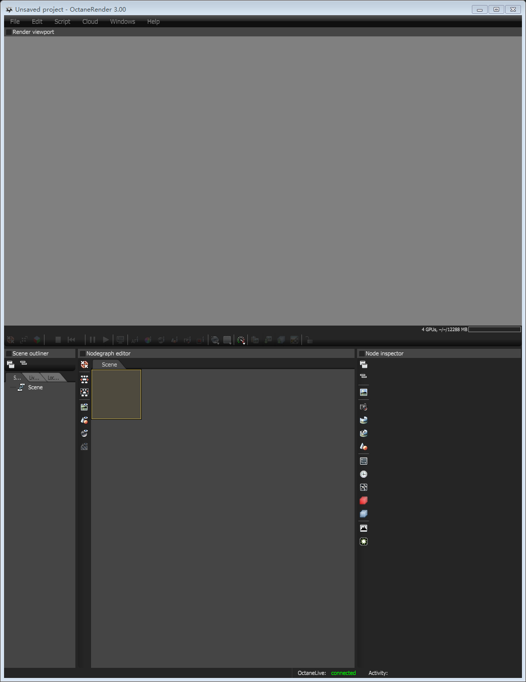

I followed your advice, and I can get a custom layout, and I attached it with this post. But if I just want to show the Render viewport, and disappear the scene outliner, nodegraph editor, and node inspector, How to do it?
Thanks,
Bootan

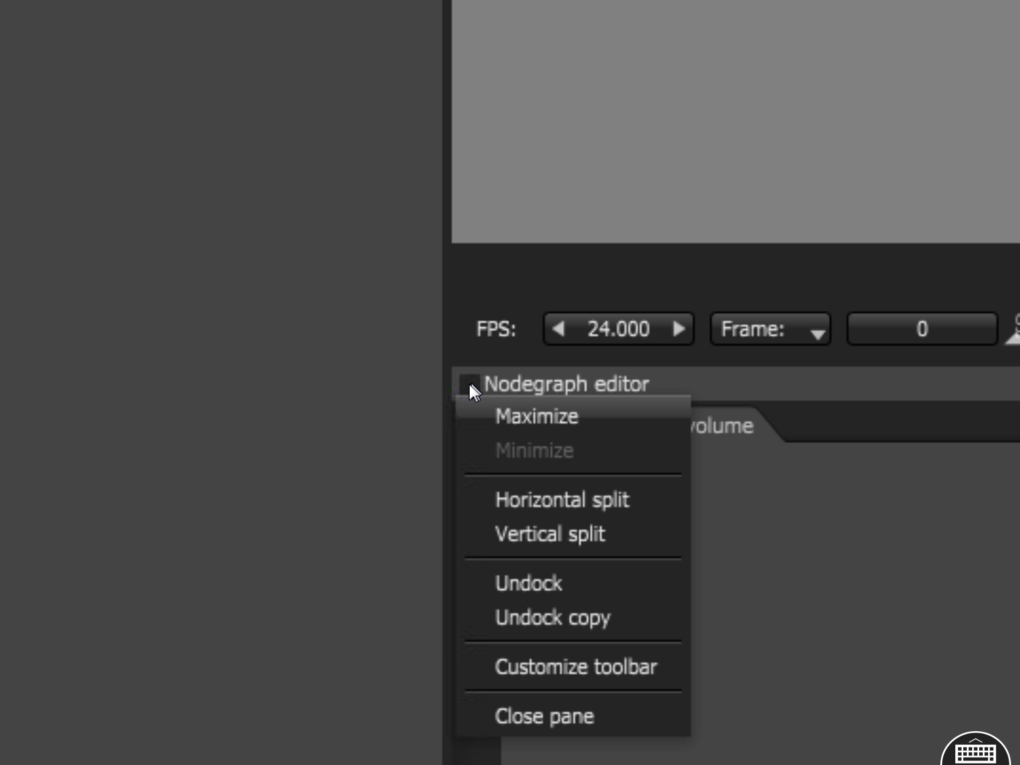

Posts: 10634
if you right click on the little black square at the left of the panel title, you have several options, here you can also close a panel:
Do it for the panels except for the Render View and save the layout as default ;)
ciao beppe
