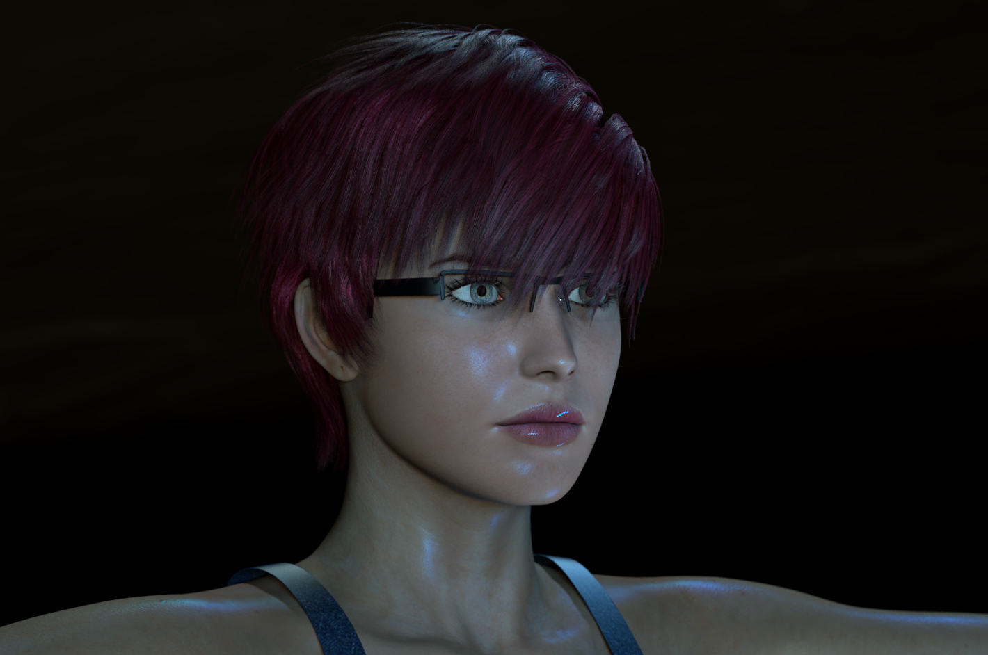

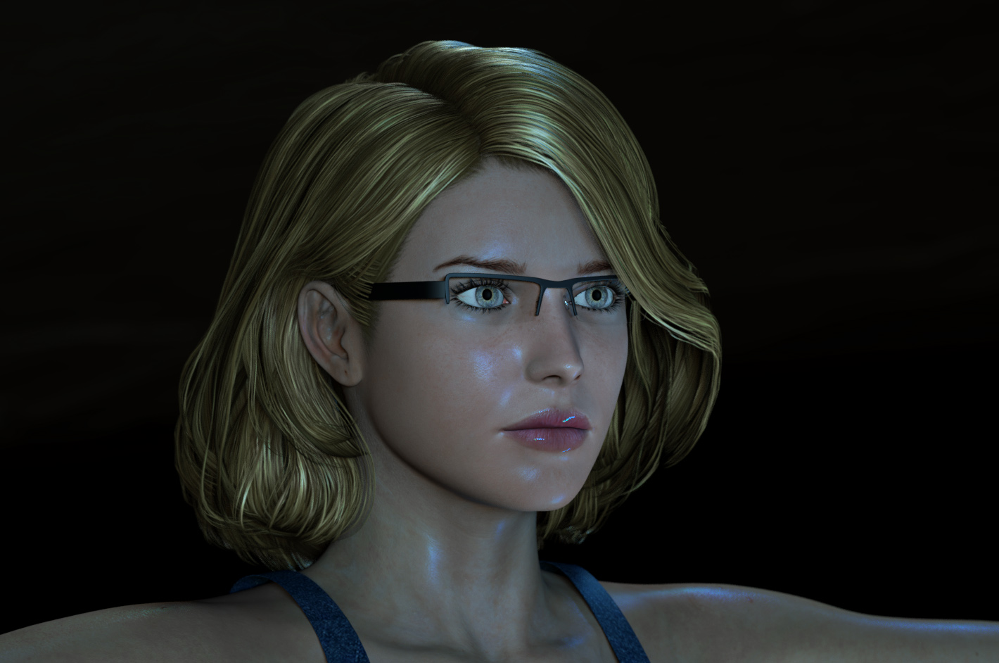

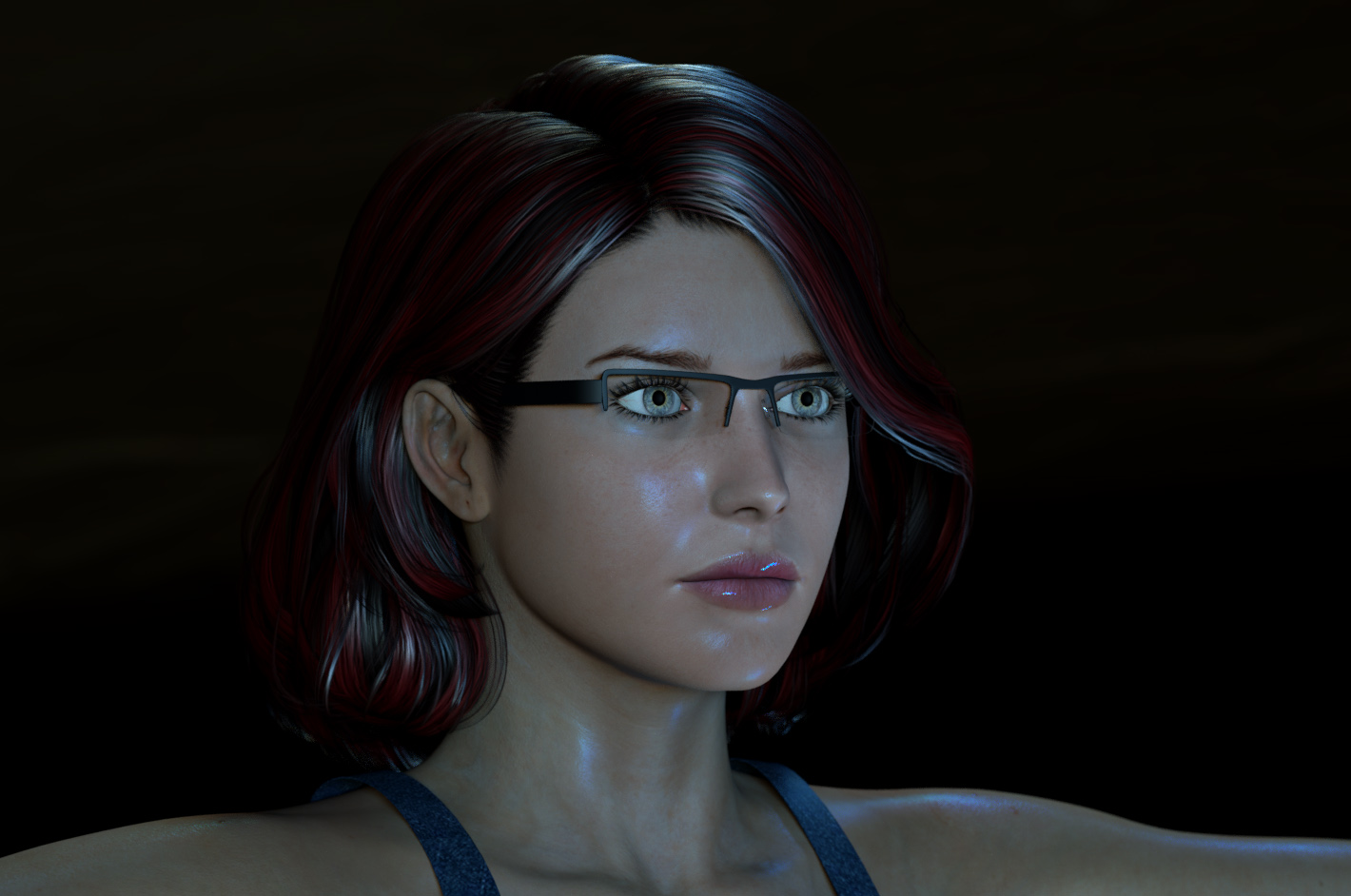

Here is one of the blonde textures applied to all of the three hair parts (M1, M2 and M3 in the Octane Setup window). The other image show three separate textures, each applied to a different part of the hair. You can mix and match them as you like. In both images, I have specular power set at 0.7 and roughness at 0.5.
The image with the red hair is called Pyrit Hair, which has very nice strand details. Unfortunately that one only comes with the red texture, but you can always adjust that in Photoshop to make other colours.
While these results look alright - the glossiness levels of the hair seem to be off.
The hair looks too close to plastic.
You could try using an external hair shader like RedSpec TGX Hair in order to further enhance your hair renders.
