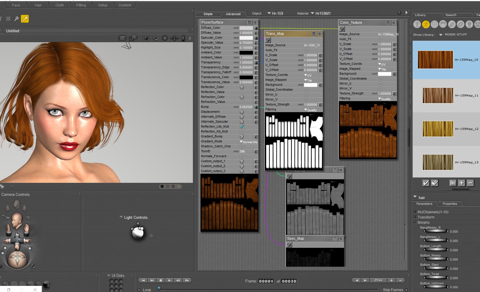

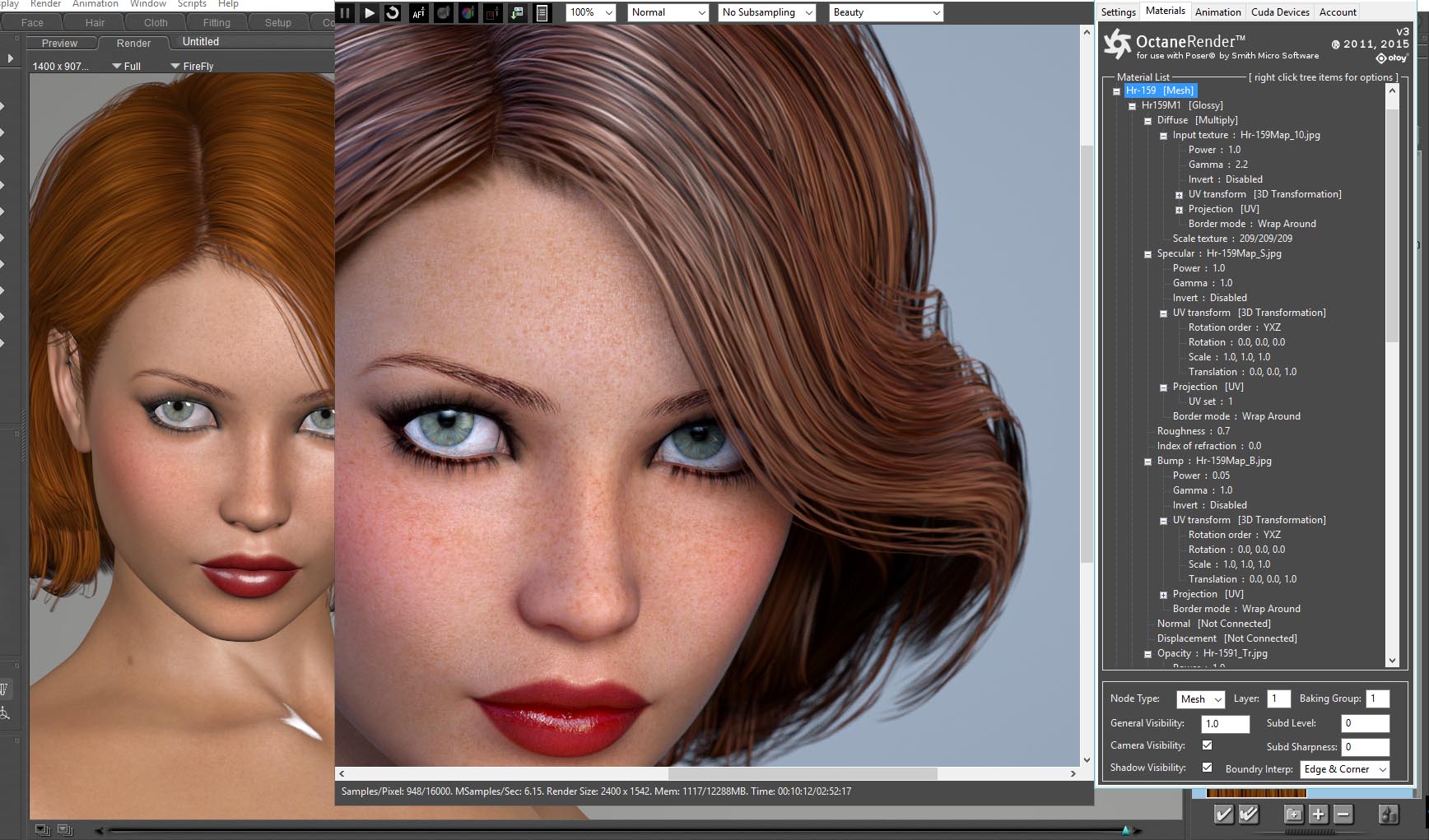

Yes, my apologies.. I don't know enough how to ask properly which question. Attached are 3 images which I hope will be able to shed some light onto what I'm missing in the process.. The Poser colour is what I am trying to bring over to the Octane image.. but as you can see its not quite right by a long shot..?

I think it is bringing over the texture color. The color difference might be due to the specular, which is reflecting the background in your Octane render.

Set the gamma of the specular map to 1 and lower the specular value. Also lower the roughness. The combination of these three now causes the color to change due to reflection

wimvdb wrote:Set the gamma of the specular map to 1 and lower the specular value. Also lower the roughness. The combination of these three now causes the color to change due to reflection
Yes, that worked rather well.. takes a bit of tweaking to figure out what works best to achieve the right colours.
