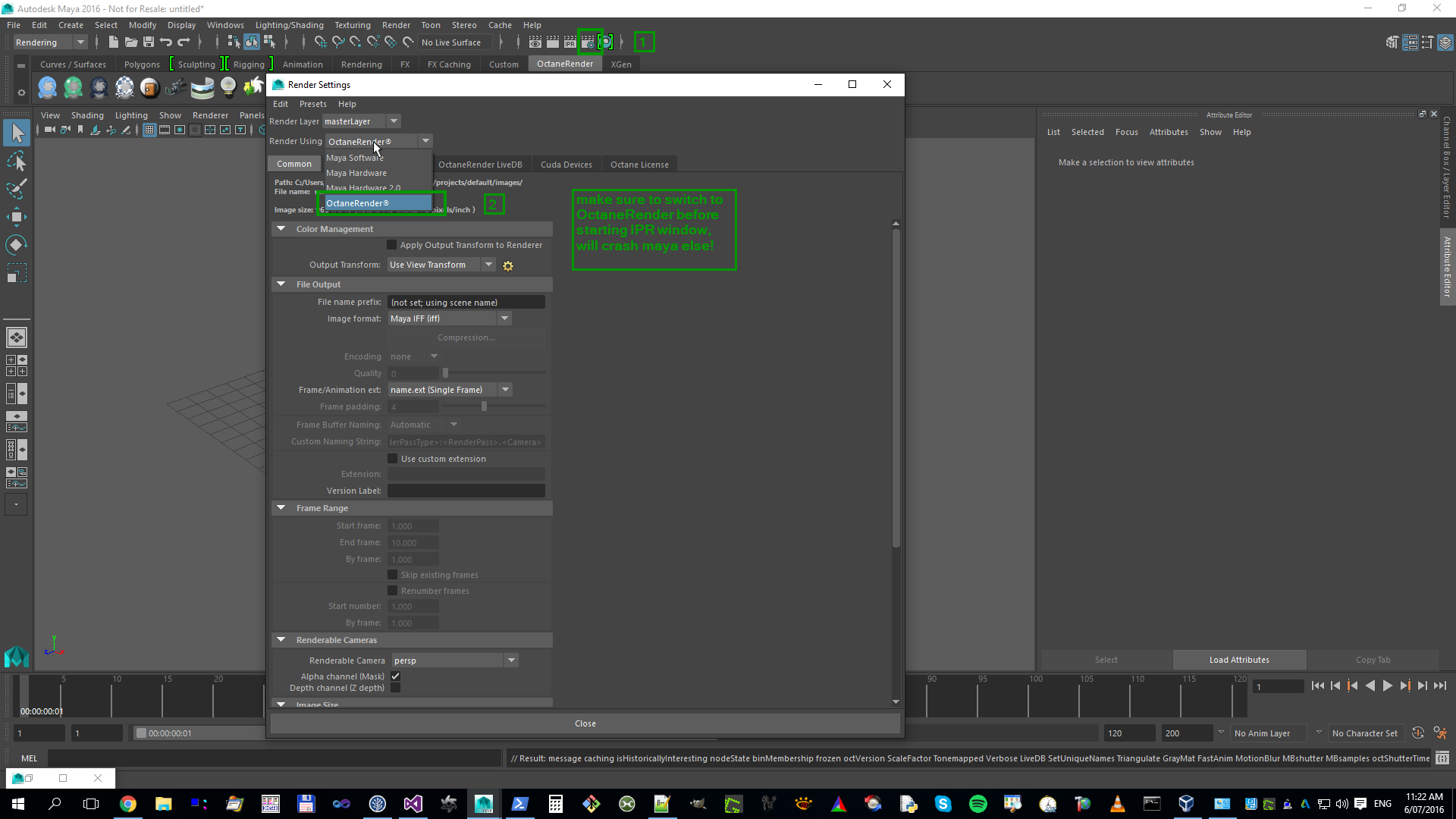

Switch to Octane Renderer before opening IPR Window, else Maya crashes:

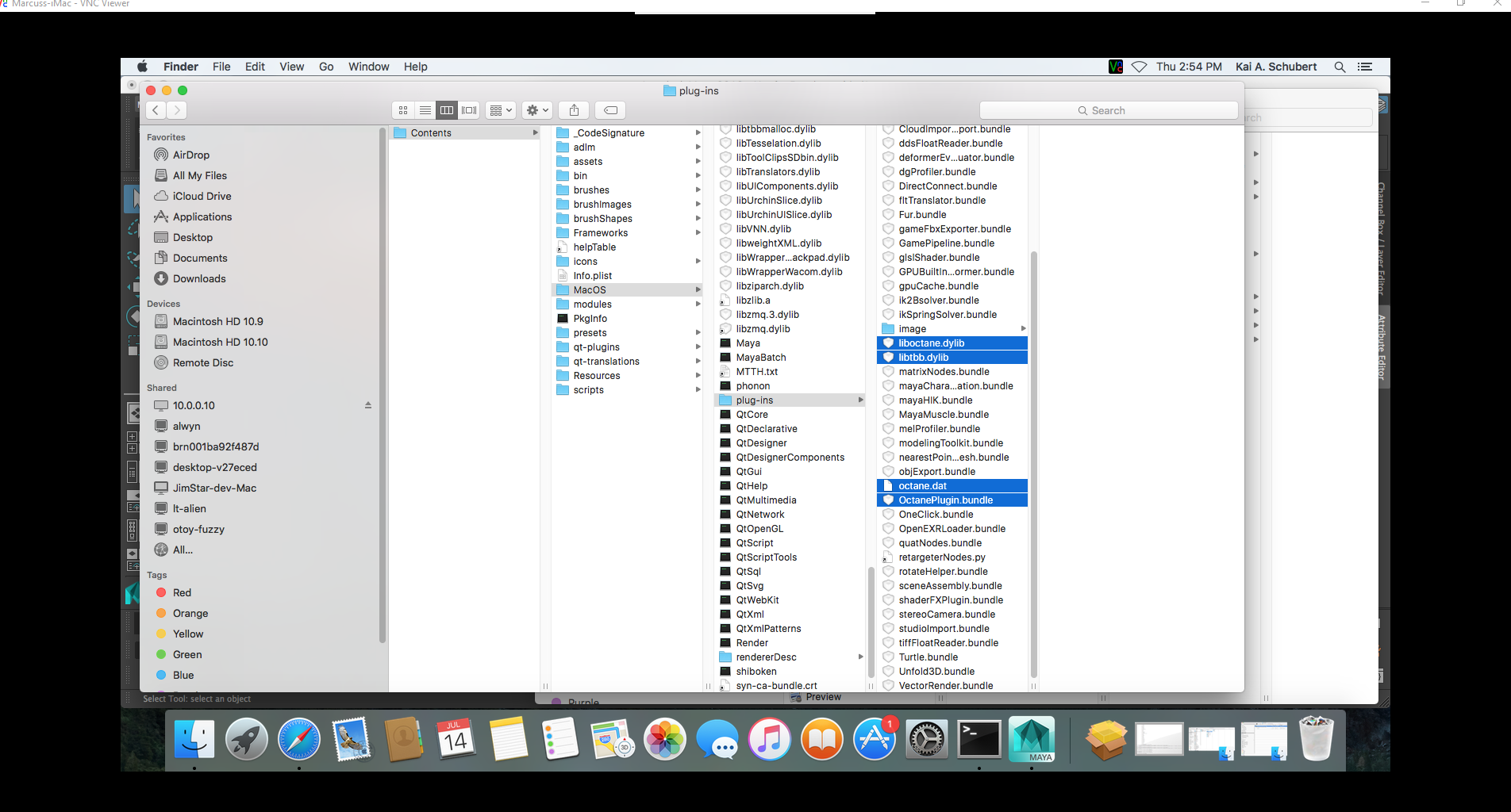

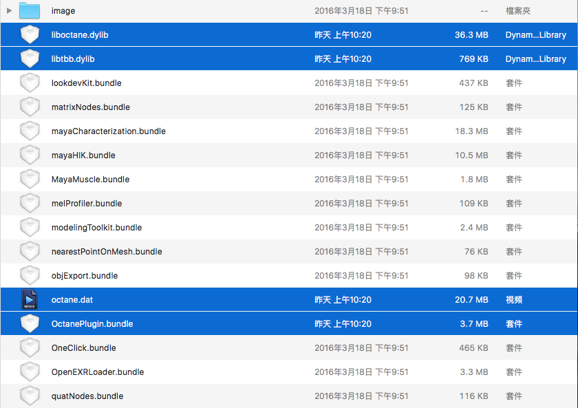

Could you please send a screenshot of your maya.app like this one:
The 4 files should be right there in the plugins folder.
Running here on my testing Mac.

Here you are

Hmmm, than it should work, the libtbb.dylib is right there next to the .bundle.
Tested it back and forth on my Mac here and thats the setup that works...

Did you select OctaneRender as renderer before opening IPR?
Else if you don't have the basic node graph created (at least RenderTarget, FilmSettings and GeometryGroup nodes), it can crash, fixed that and will release update soon
and new automatic node generation will mitigate this problem anyways.
