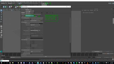

Switch to Octane Renderer before opening IPR Window, else Maya crashes:
