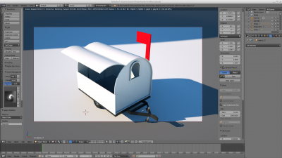

Here's my latest project. I have to turn off "SMOOTH" on the material properties, but then it only renders as faceted. If you turn on "SMOOTH" it has screwed up normals and renders ugly. This is for any object. Even if you make it native in blender or import it from another source.

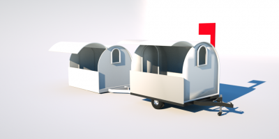

FYI - I exported the scene as an .orbx, imported it into the standalone, then imported the .obj mesh, then attached the "smooth" white material to the .obj. This "smooth" white material is the same on used on the .orbx model.
This is what I'm describing as the problem. The object mesh is somehow reordered via polygon, so that some are flipped and other are not. I think that the points are reordered in a way that still constructs a polygon, but are clockwise instead of counter-clockwise (or something like that). This is why they shade from light to dark when they should be solid. (Just spit balling, I really have no clue what is wrong).

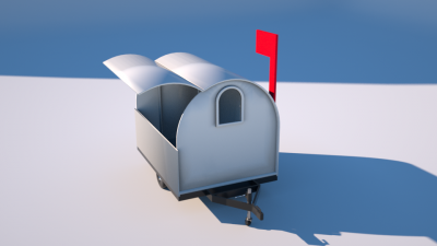

It's definitely a problem with your geometry. The walls have two planes that are connected with other polygons on the edges. This causes all sorts of problems for Octane to interpolate the surface normals. With 90 degree bends in the geometry it will cause that ugly shading. There are several ways to fix it. The easiest is to just select each object you are having a problem with and apply an edge split modifier. This separates any polygons that have a greater than 30 degree angle between them (so your 90 angles would be split). Now Octane doesn't interpolate over the sharp edges and ignores them.
Another fix would be to edit each object and select the edges. Then apply a bevel on them to add more geometry and lower the angle between the polys. Another fix would be to separate the faces of the walls and the edges into individual objects. Here is what I get when I applied the edge split modifier:
