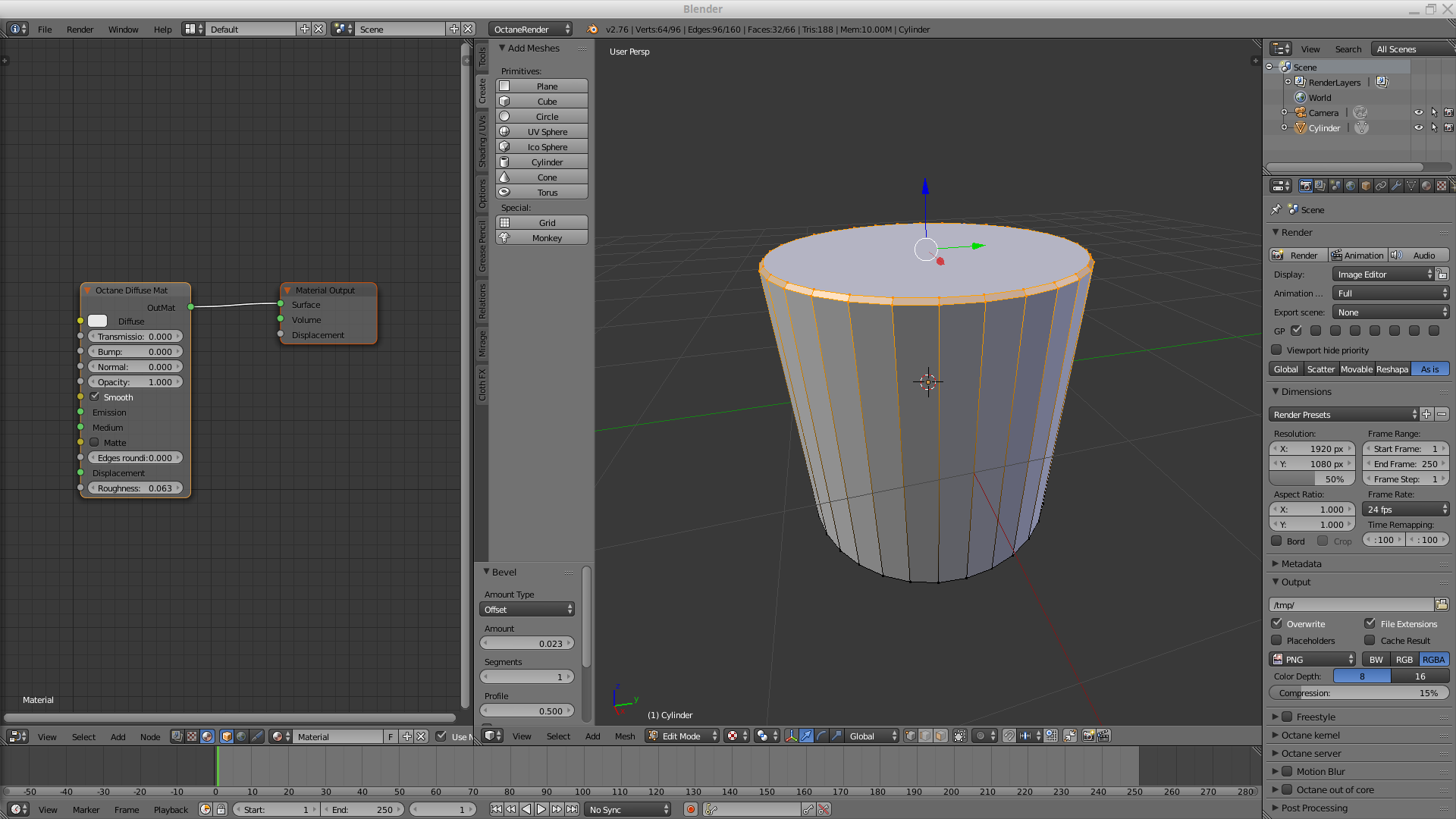

I have some sort of issues with the surface normal, even on simple primatives (like a cube or cylinder) . I've tried flipping the faces and it just doesn't resolve the issue.
Look at the surface of the rectangle. If I make a cube it has these strange radial markings (like anistropic textures). Is there any work around? I'm in the middle of a project.
Notice the odd shading due to bad normals

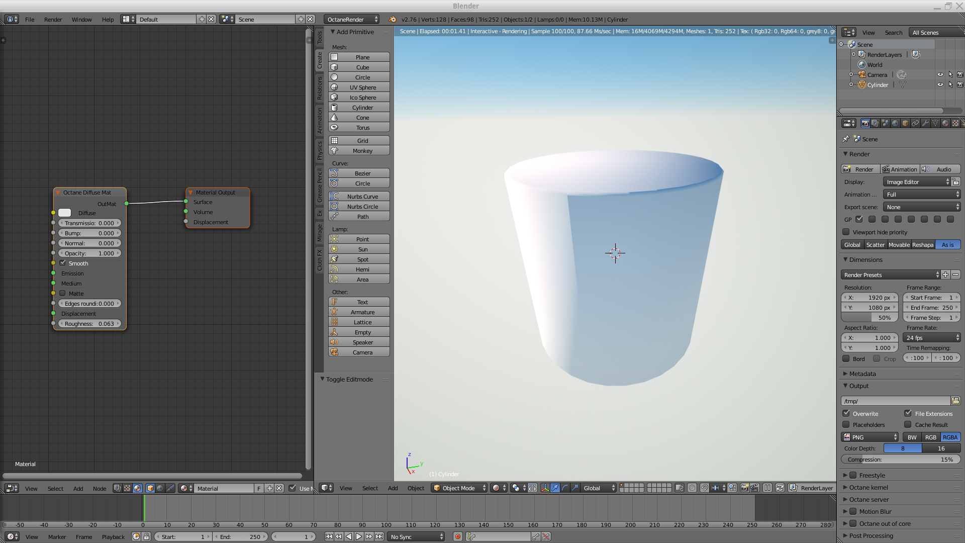

So I created a cylinder and rendered it with Octane:

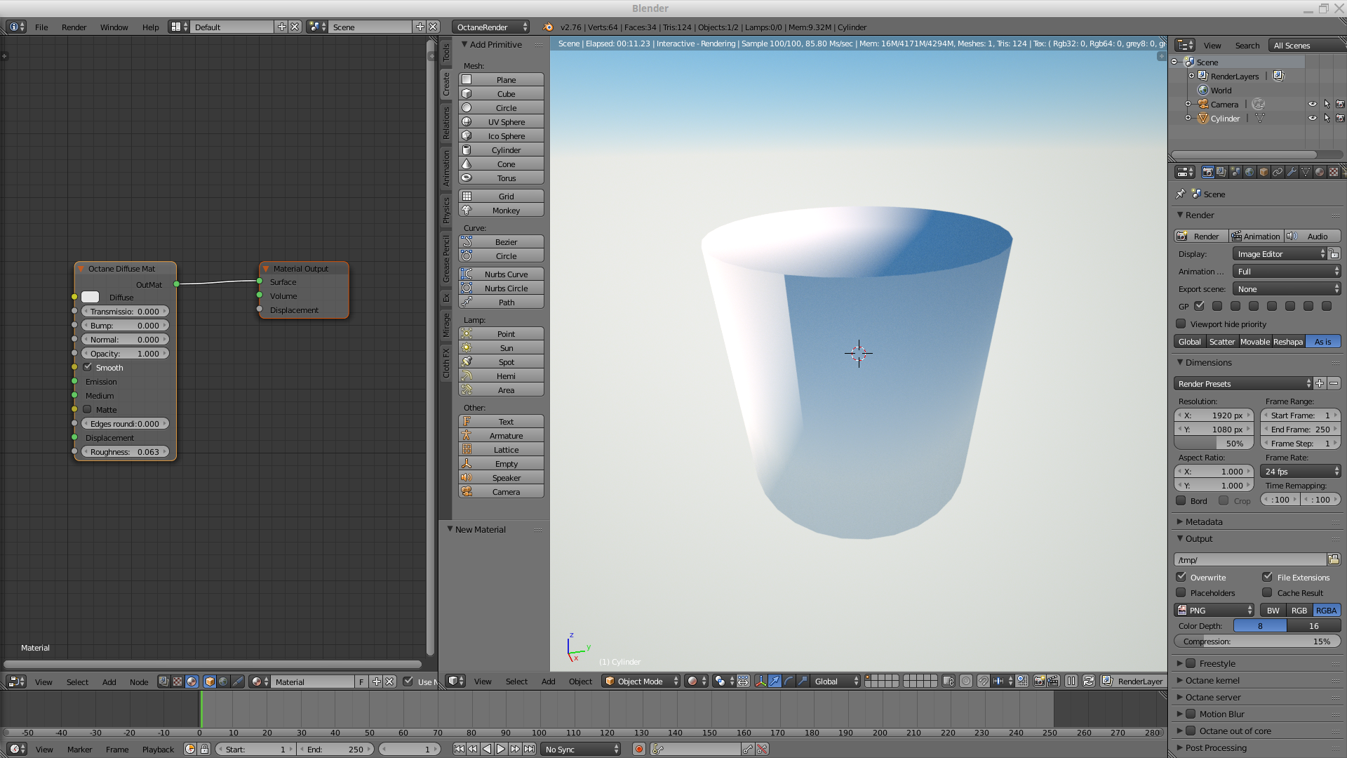

It looks like junk. Now I bevel the edges to the cylinder like so:
Now when I render it, it looks better but still could use some more geometry.
The problem is not with Octane or any renderer, it's because the surface normals are being interpolated from one vertex to another. There are limitations to this technique and you have found them. If you want to understand better read up on Phong shading like here or other sites that talk about it.
https://en.wikipedia.org/wiki/Phong_shading
Now you can get shadow terminator errors which causes the edges of the shadows to be blocky. Octane 3 handles this better than version 2 so it will look better when the Blender plugin is updated.
