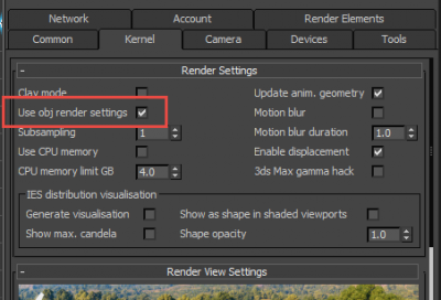

This works in 3ds Max plugin too.
You just need to enable it in settings.

Thanks!
I didn't find it in manual. It's not quite obvious - renders like vray and corona use modifier's settings by default.
