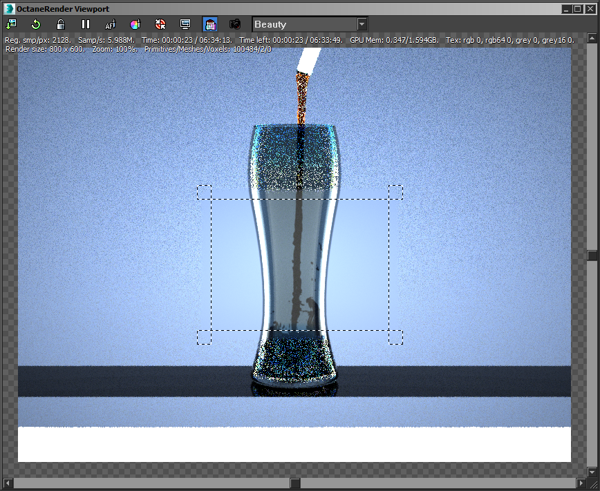

Region render is not working. I can manipulate the region but it has no effect, it renders the whole image anyway.
4.3 max plugin build Region Render not working

Hi Helden,
you could use the region command instead of crop.
select it in place of the crop command, and you can manage it directly into viewport or into the render window frame.
Regards
Paride
