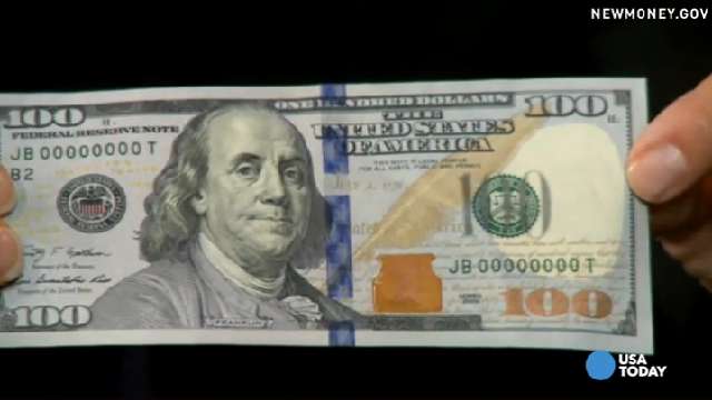

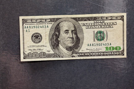

very nice work
how do you handle the security strip in vintage (2012-2014) of printed money and new ?

Marvez wrote:very nice work
I would go the same way: just add another mix node and mix a strip texture with the current mixes. Just make sure to use it only for the transmission. I suppose it should be completely invisible in diffuse channel. At least judging from the second image. As for the first one, I would create a new material separetely for the strip (maybe make it glossy with some colourful gradient in the specular channel) and use a mix material to mix my current material with the strip material and used a B&W mask as amount.
To be honest I haven't seen the new banknotes in real life, so it is pretty hard to judge how it really interacts with light.
