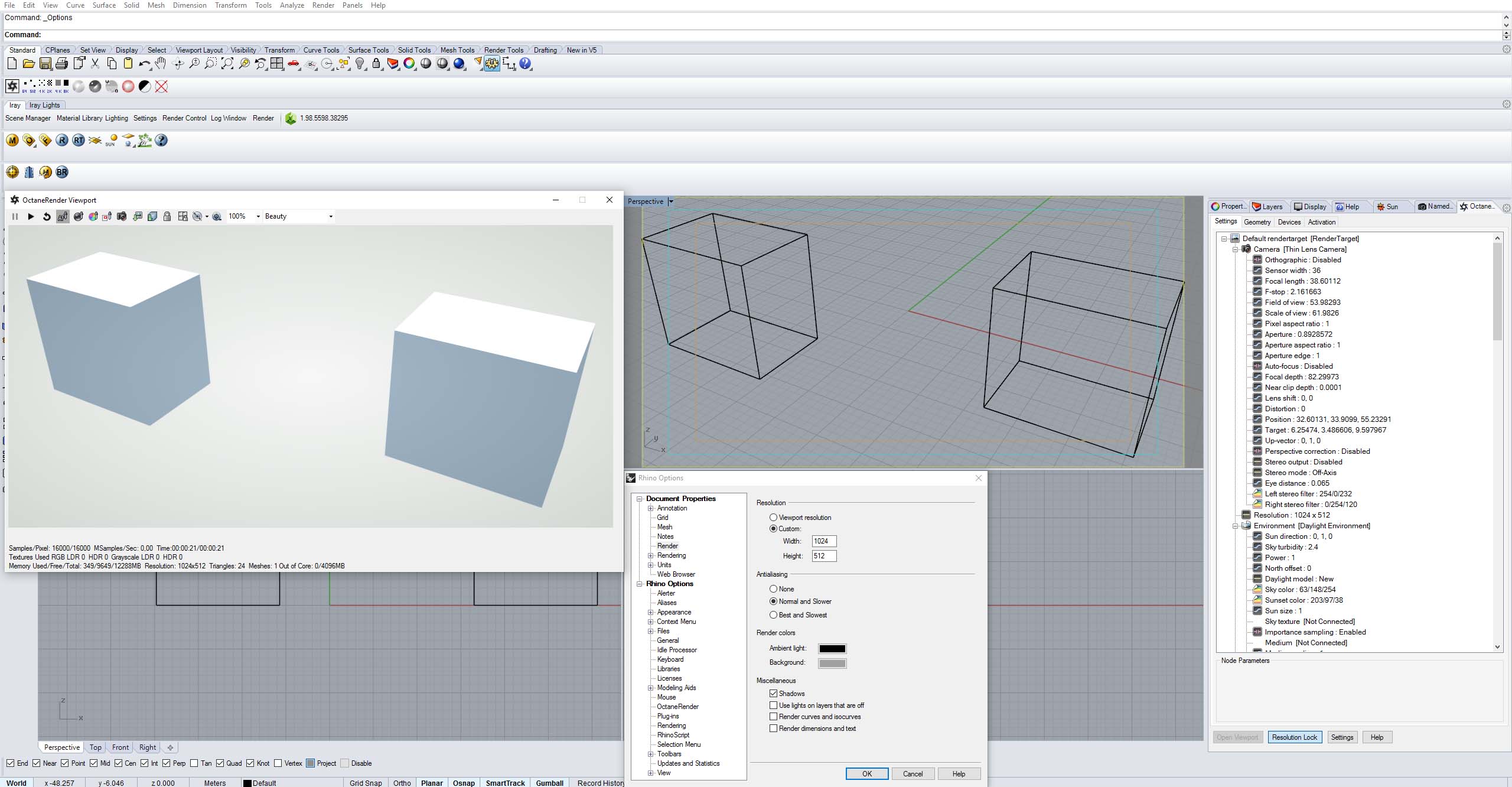

HI Paul,
this is an example of the viewport not matching Rhino's save frame.
The viewport should end with the corners of the cubes.
How can I fix this?

Hi Paul,
is there a solution for this?
We are having trouble here.
When we rerender shots they are not matching perfectly.
Ciao
Nando

Posts: 15809
Location: Adelaide, Australia
I put a fix for this in 3.0.22.66. Is this still an issue in the latest release? If so - can you post a sample Rhino file which shows the problem pls.
