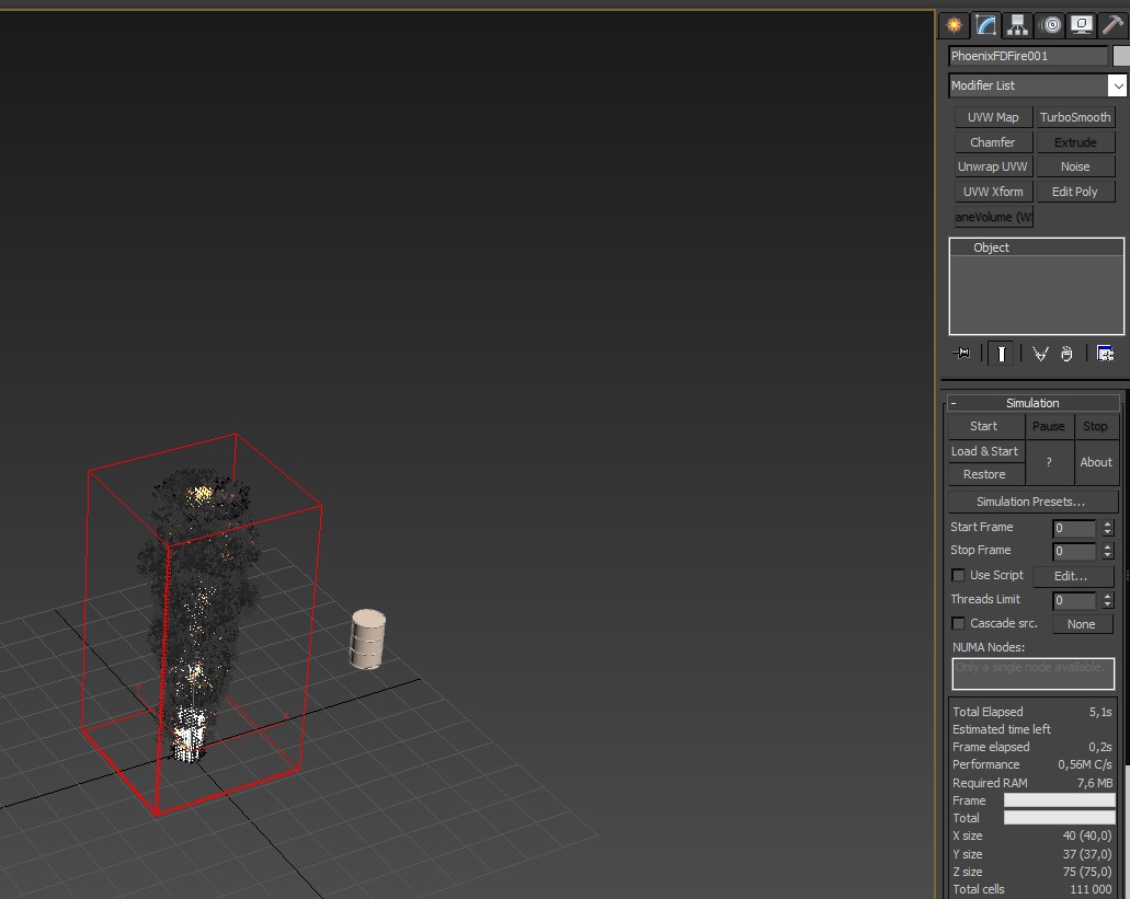

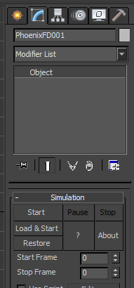

As you can see on attached file, OctaneVolume don´t recognize the Phoenix Object. I´m using phoenix 2.2, Octane v3.02 - 4.1 on Max 2016
In fact it don´t even appear on Modifier list, so I putted it on the buttons to see whats happen.
Using Octane 3.02 - 4.0 it recognizes the object but seems to be something "experimental" as it doesn´t work on the final render.

Yes I was following that. The attached image is a screenshot on 3.02 - 4.1
I didn´t save the scene but its easy to recreate... its just a Cylinder inside the Phoenix object linked on a Phoenix source. Nothing else.
But even just creating a Phoenix Object without any simulation or anything in the scene it doesn´t recognize it as a phoenix object aswell.

Hey Jim, I could make it work...
in fact there was 2 things happening.
1 - I think I was using some newer version of Phoenix, probably some nightly build. Now I tried with a 2.2 demo version and it works.
2 - The OctaneVolume (WSM) still not showing on modifiers list, but I got why. I usually set my modifiers to: "SHOW ALL SETS IN LIST".
If I deactivate the: "SHOW ALL SETS IN LIST" I can find the modifier there, together with the other WSMs.
