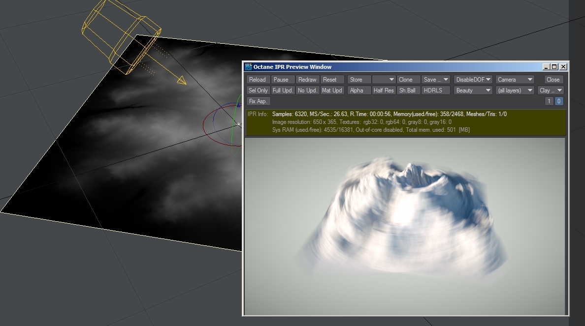

Hi, i have a problem with Motion Blur.
The only object that is blured is the "cup" but in wrong way. it's always blured if it is not moving too. And other objects are not blured?
I use Octane 3.02 -LW Plug-in
Someone had one idea?
Thank you very much.
Luca

Have you tried to render the scene with F9/F10? The deformations motion blur can't be rendered in the IPR window due to LW SDK limitations.
Anyway the cup object motion blur is weird issue. Is it a instance?
If you want to send to me the scene, I could test it here to find where is the problem.

Yes, sorry, the problem seems that Octane doesn't support the mesh deformations motion blur in the surface has a displacement. You are going to need to use the LightWave native displacement, or find other workaround (perhaps a more detailed model with bump or normal maps).
-Juanjo
