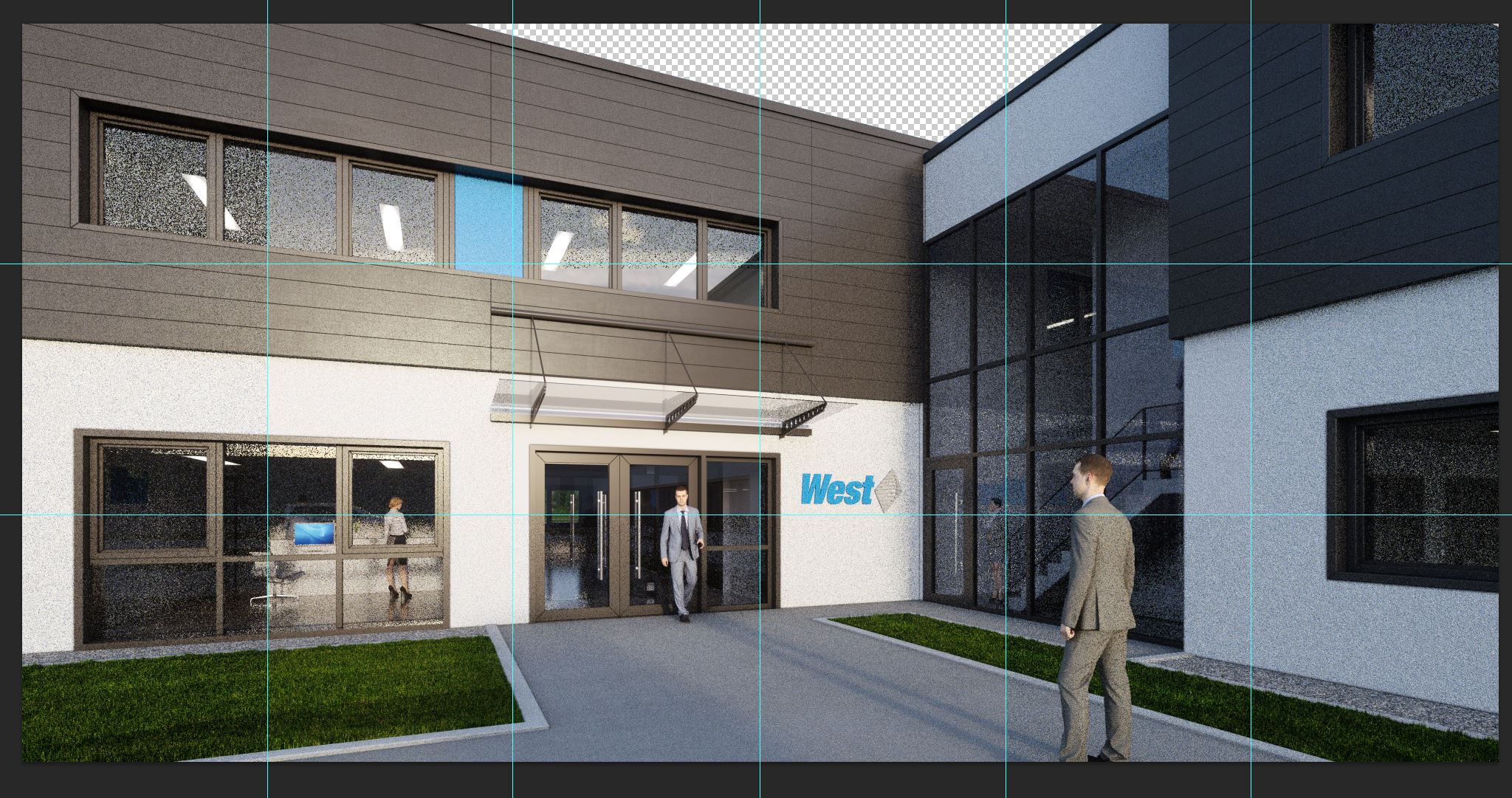

Hello, I am experiencing similar issues in octane for Rhino, It seems that octane tries to identify zones which need more samples to clear than others and distributes its power accordingly.
Sometimes this seems to work OK but often I get nasty tile artifacts...
We need an option to turn this behaviour off ASAP!
attached an example picture (blue lines are PS ...)

wafflelad wrote:Does it still happen if you turn Max Tiles down to 1? It seems to be a byproduct of how the tiling works.
thanks wafflelad, this seems to do the trick... maybe there should be a warning in the flyout info of this setting, mentioning the possible tile problem.
