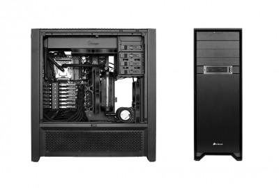

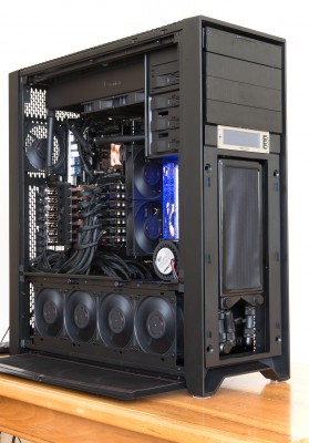

yeah @ Liketheriver neither case is pretty, that's for sure. Definitely not the bell of the ball by any means...
The X9 does seem like maybe a better option. I was a little iffy on whether there was enough room from the base where the mother board lays to the top of the case for all the hoses. Seems like it might get pretty cramped and the hoses may be kinked a bit or something.

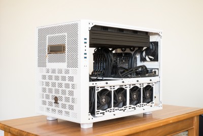

Ofter 900D and TT Core X9 - the X9 is a definite winner, not only due to its horizontal mobo layout which is extremely important in gravity force reduction that heavily affects PCIe slots, but also to its incredible functionality - 3x480 easily fitted there, less fittings, simple and more effective drainage system.... If you don't mind wider case - which personally I prefer - go with X9.

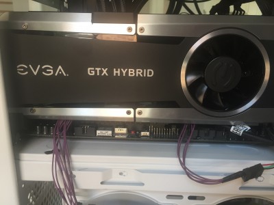

Hey guys! So I ended up pulling the trigger on the 4 hybrids and the thermal take x9. So far everything fits great EXCEPT...
The 4th GPU is conflicting with the HD audio and USB headers on the x99-e WS motherboard. I can't push the 4th GPU all the way in due to the cables sticking out.
Maybe there's an easy solution, I'm pretty green to PC building.
Any suggestions?
Thanks!

Incase anyone else has this problem... I picked up some breadboard jumper wires with flexible ends and they worked great to give more clearance. Not the cleanest solution but I got the 4th card in.
